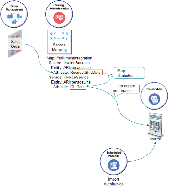

            Use the Pricing Administration work area to create a service mapping that maps an attribute value from the sales order in Order Management, such as the requested ship date, to the GL Date attribute in Oracle Receivables. You modify the FulfillmentIntegration service mapping. It doesn't affect pricing, but it does use some of the same processing that Pricing uses. That's why its in the Pricing Administration work area.

Set up the service mapping so it can map the GL Date attribute.

                     In the ARInterfaceLine area, on the Attribute Mappings tab, click Actions > Add Row, set the values, then click Save. Attribute Value Attribute GlDate Expression Enter now().This value sets GlDate to the current date of the Oracle server instead of using the actual ship date. It assumes you're shipping the item on the current data and time. You can also set the GL Date only for business units that you specify. OrgId in [list]?now():nullwhere -

 For example, set GL Date only for business units 204 and 205, and set it to the requested ship date. OrgId in [204,205]?RequestShipDate:nullView Object Attribute To populate your date according to an attribute, leave Expression empty and specify the attribute in View Object Attribute. For example, to set the GL Date to the same value as the requested date, enter RequestShipDatein View Object Attribute.If you set a value in the Expression, then leave View Object Attribute empty.

                     In the InvoiceService area, in the Entity list, click the row that has ARInterfaceLine in the Entity column.
                     In the ARInterfaceLine area, click Actions > Add Row, set the value, then click Save and Close. Attribute Value Attribute GlDate For example, query for sales order 56486. select gl_date, trx_date, ship_date_actual, creation_date, inventory_item_id from ra_interface_lines_all where interface_line_attribute1 = '56486'For details, see Use SQL to Query Order Management Data.
