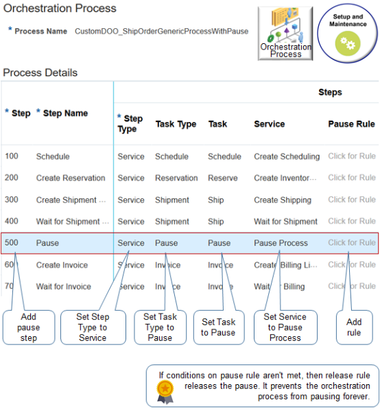

Add Step That Has a Pause Task
Add a step that references a pause task.
         Note
               Use the Edit Orchestration Process Definition page in the Setup and Maintenance work area.
               Add a pause step. Set these values: Attribute Value Step Type Service Task Type Pause Task Pause Service Pause Process
               Click the link in the Pause Rule column to set up your release rule. You typically use line-selection criteria to filter fulfillment lines that the orchestration process step processes. However, line-selection criteria isn't available for a pause task because the pause task already examines every fulfillment line in the sales order, by default.

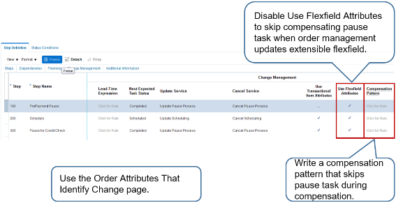

Pause When Revising Sales Orders
Pause when the Order Entry Specialist revises a sales order. You can set attributes that control this behavior.
         Note
               If your pause task doesn't reference an extensible flexfield, then disable the Use Flexfield Attributes option to instruct the orchestration process to skip the pause step when the value in an extensible flexfield changes.
               If you don't need to run your pause task when revising a sales order, then write a compensation pattern. Assume you write a pause step that waits for payment. The Order Entry Specialist manually indicates that the customer sent payment, and the pause ends. Some time later, the Order Entry Specialist revises the sales order in a way that doesn't affect the payment amount, such as modifying the ship-to address. It isn't necessary to pause to wait for payment after the revision, so you can write a compensation pattern that skips the pause on the payment step.
               The orchestration process uses the attributes that you specify on the Order Attributes That Identify Change page to determine when to compensate while revising a sales order. Use it to make sure your pause task runs only if the revision that the Order Entry Specialist makes affects an attribute that your pause task references. For details, see Manage Order Attributes That Identify Change.

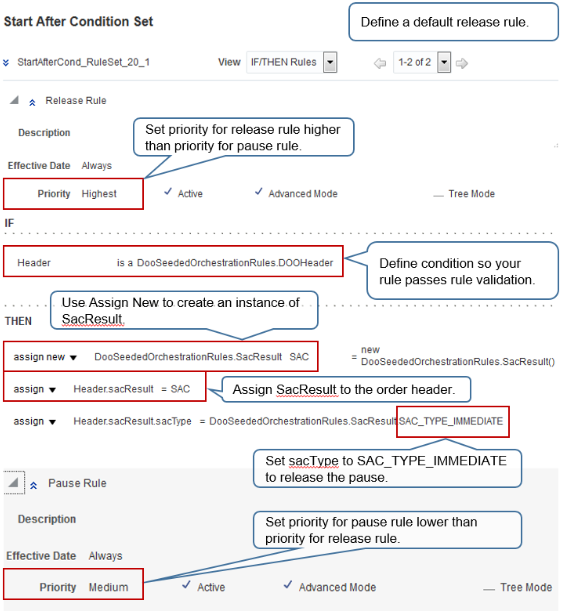

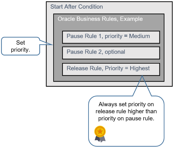

If you set up more than one rule that runs as a set of rules on the same start after condition, then you must set the release rule to the highest priority of all rules in the set.
         Here's an example of a release rule and a pause rule together.
         Note
               Order Management runs the rule with the highest priority first.
               Set the Priority attribute to Highest on the rule where you use Assign New. This makes sure the rule runs first. It also makes sure that this rule creates the object that stores the result of the start-after condition (SAC). Other rules might set the value for the start-after condition.
               If you only have one rule in your rule set, then you don't need to worry about setting priority.
               If you don't set the priority correctly, you might encounter a null pointer error when Order Management runs the rule.
               Don't use the If statement on the release rule to define the condition that your business logic requires. Instead, set up your conditional logic on the pause rule.
               The rule editor requires that you set up a condition on the release rule so it passes validation, so set up a condition that's always true.
               Use Assign New. Assign New creates a new instance of SacResult so you can assign values to it while the rules in your rule set run.

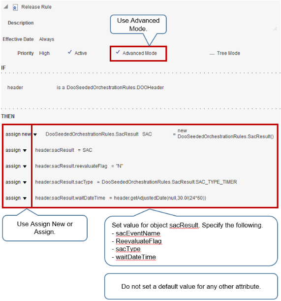

Another Example of a Release Rule
         Note
               Use advanced mode.
               Specify sacResult. Attribute Description sacType Required sacEventName ReevaluateFlag waitDateTime Optional, depending on the type of pause. For example, if the rule pauses according to a dependency to resolve, then you must include sacEventName. For details, see Overview of Pausing Orchestration Processes.
               Don't set default value for other attributes.

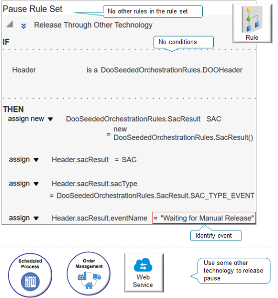

Use Some Other Technology to Release Pause
You typically use a release rule to release a pause. However, you can also use a web service, scheduled process, or the Order Management work area to release the pause.
         Note
               Use only one rule in your rule set.
               Don't specify a condition.
               Use some other technology to release the pause task.

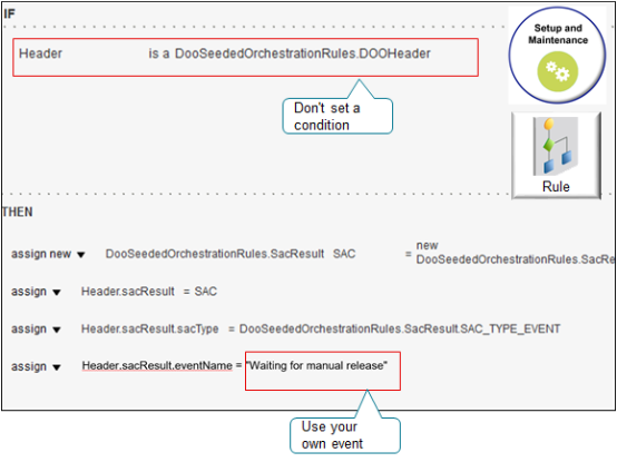

Don't Include a Condition
If you manually release a pause or release it through a web service or scheduled process, then don't include a condition or default release rule. Here's an example where you send shippable and nonshippable lines together to invoicing, and you want to control when to send these lines.
         You can specify your own eventName, such as Waiting for manual release. The Order Management
work area will display this name. You can also specify it on the scheduled
process that you use to release the pause.
Assign the Result
You must include these assignments as the first two actions in your Then statement:
| Code | Description |
                            | Create a new variable named SAC and set it to the SacResult type in the DooSeededOrchestrationRules method. |
                            | Set the value of sacResult on the order header to the value that SAC contains. |
This code creates the object that stores the result of the start-after condition (SAC).
If you don't include these assignments, and if you don't create a release rule, then at least one of the rules in your rule set must use the Assign New action to create the SAC object.
