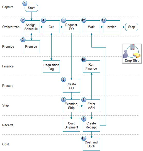

Each horizontal row in the diagram represents a system or application.
The drop ship flow is a variation of the order-to-cash flow.
Order Management comes predefined to capture sales orders in the Order Management work area. You can also capture source orders in an order capture system that resides outside of Order Management.
Order Management assigns an orchestration process to the sales order, uses the Schedule Order task to start scheduling the sales order, then sends a scheduling request to Global Order Promising.
Global Order Promising considers sourcing rules, supplier calendar, capacity, and so on to identify the supplier and supplier site that can fulfill the order in the most efficient way. If the sales order specifies a supplier, then Global Order Promising uses this supplier.
The orchestration process gets the requisition organization from Supply Chain Financial Orchestration so it can create a purchase request.
Order Management sends a purchase request to Oracle Procurement.

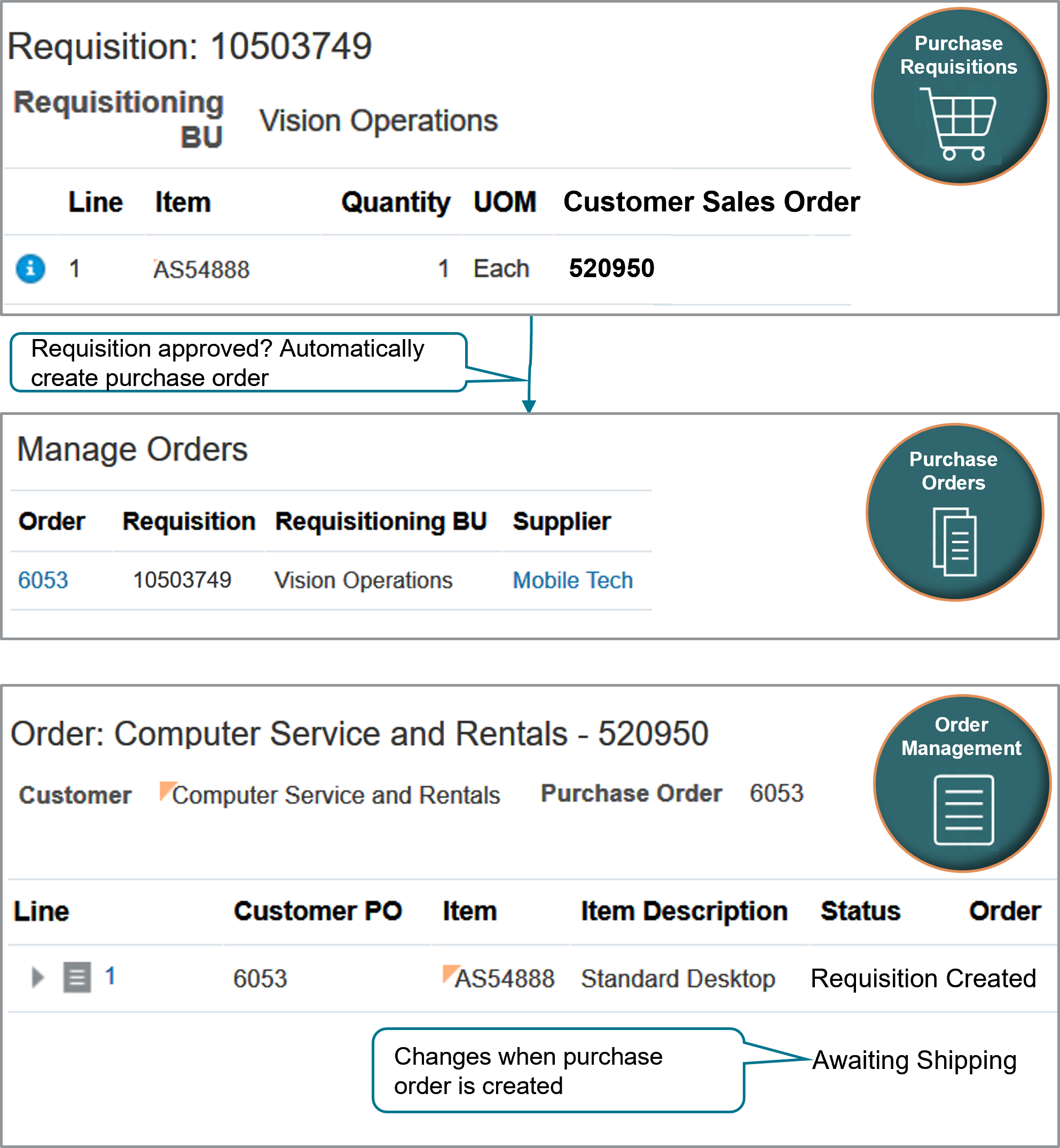

Procurement creates a purchase requisition, approves the requisition, creates a purchase order, then sends the purchase order to the supplier.
Note
This Attribute
References This Attribute
Customer Sales Order attribute in the Purchase Requisitions work area
Number attribute on the sales order in the Order Management work area
Requisition attribute in the Purchase Orders work area
Requisition Number attribute in Purchase Requisitions
Drop Shipment PO attribute on the Supply Details tab of the fulfillment line in the Order Management work area
Purchase order
Requisition attribute on the Supply Details tab of the fulfillment line in the Order Management work area
Purchase requisition
Order Management sets the order line status when Procurement creates the requisition and the purchase order.

Creates the requisition.
Requisition Created
Creates the purchase order.
Awaiting Shipping

The supplier examines the purchase order and uses your shipping fulfillment system to ship the item to the customer. The enterprise supplier also communicates with the receiving part of Inventory Management to cost the shipment.
The supplier uses a supplier portal to enter an ASN. Order Management sends the notice to interested parties and Financial Orchestration. For details, see Supplier Portal Integration.
The receiving part of Inventory Management creates a logical receipt in the receiving organization. It doesn't create a physical receipt because the supplier ships the item directly to your customer.
Financial Orchestration runs a financial flow that comes predefined to handle drop ships, and that specifies how to handle the flow that runs from the supplier to the customer.
Cost Management does receipt accounting and cost accounting.
Order Management waits to receive the advance shipment notice from receiving. The notice indicates that the item shipped and that the customer acknowledged receipt.
Order Management communicates with Oracle Receivables to create an invoice and process payments.
