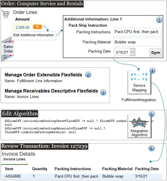

Integrate Your Own Order Line Attributes Between Order Management and Oracle Receivables
Use an extensible flexfield in Order Management to capture your own order line details, then send them to a descriptive flexfield so you can see these details on invoices in Oracle Receivables.
Note
  1. Assume you need to add your own shipping details when you create an order line for a new sales order in Order Management. The Order Entry Specialist clicks the down arrow in the Amount column on the order line, clicks Edit Additional Information, then uses it to add the details.
    • Packing instructions
    • Packing material
    • Packing date
  2. You will add these attributes to the Fulfillment Line Information extensible flexfield.
  3. You edit the Invoice Lines descriptive flexfield so you can display shipping details on the invoice line.
  4. You modify the FulfillmentIntegration service mapping to map the extensible flexfield between Order Management and the descriptive flexfield in Oracle Receivables.
  5. You create an integration algorithm that specifies the data to communicate.
  6. You use the Billing work area to examine the invoice that contains the shipping details.
Summary of the Setup

Edit Extensible Flexfield
Create the extensible flexfields that your Order Entry Specialist will use to enter shipping details on the order line.
  1. In the Setup and Maintenance work area, go to the task.
    • Offering: Order Management
    • Functional Area: Orders
    • Task: Manage Order Extensible Flexfields

Edit Service Mapping for Extensible Flexfield
Edit a service mapping so Order Management can send attribute details to Oracle Receivables.
  1. Go to the Pricing Administration work area.
    Use order administrator privileges so you can access the integration algorithm and service mappings that you use in the Pricing Administration work area to set up the integration.
  2. Click Tasks, then, under Order Management Configuration, click Manage Service Mappings.
  3. Enter your sand box.
  4. On the Manage Service Mappings page, in the Name column, click FulfillmentIntegration.
  5. Add an entity.
    • On the Edit Service Mappings page, on the Entities tab, click Actions > Add Row, then set the values.

Create Integration Algorithm
To implement the logic you need, you will modify the integration algorithm from another help topic.
  2. Click Tasks, and then, under Order Management Configuration, click Manage Algorithms.
  3. On the Manage Algorithms page, click Actions > Create.
  4. On the Create Algorithm page, set values.
    Attribute
    Value
    Name
    Integrate_OM_and_AR Custom
    You can use any text, except you must suffix the name with a space, then the word Custom.
  5. Click Save.
  6. Click Variables, click Actions > Add Row, set the values, then click Save.
    Attribute
    Value
    Name
    ARIntegration
    Data Type
    Data Object
    Required
    Contains a check mark.
    Input/Output
    Input and Output
    Internal Service Schema
    FulfillmentIntegration.InvoiceService
  7. Click Algorithm.
  8. Click Add Step > Conditional Action.
  9. In the Data Sets area, click Add Row, then set the values.
    Attribute
    Value
    Name
    FLine
    Variable Path
    ARIntegration.FulfillLine
    Primary
  10. In the Execute Condition area, click Add Condition > Default Action.
  11. In the Actions window, add the code, then click Save.
    ARLineDFF.invoiceLinePackingDate=FLineEFF != null ? FLineEFF.orderLinePackingDate: null
    ARLineDFF.invoiceLinePackingMaterial=FLineEFF != null ? FLineEFF.orderLinePackingMaterial: null
    Here's what the code does.
    Code
    Description
    If the value of the orderLinePackingDate attribute on the extensible flexfield.
    • Contains a value. Set the value of the invoiceLinePackingDate attribute on the descriptive flexfield to the value that orderLinePackingDate contains.
    • Doesn't contain a value. Set the value of invoiceLinePackingDate to empty.
    If the value of the orderLinePackingMaterial attribute on the extensible flexfield.
    • Contains a value. Set the value of the invoiceLinePackingMaterial attribute on the descriptive flexfield to the value that orderLinePackingMaterial contains.
    • Doesn't contain a value. Set the value of invoiceLinePackingMaterial to empty.
  12. Test your algorithm, then click Save and Close.

Test Your Setup
  1. Create a sales order.
    • Go to the Order Management work area and create a sales order.
      Attribute
      Value
      Customer
      Computer Service and Rentals
    • Add an order line and set the values on the line.
      Attribute
      Value
      Item
      AS54888
      Quantity
      1
    • Click the down arrow on the order line, then click View Additional Information.
    • In the Additional Information dialog that displays, click Ship Instructions, then verify that the Ship Instructions area contains your Packing Material and Packing Date flexfield attributes.
    • Add some test values in your flexfield attributes, then click Done.
      Attribute
      Value
      Packing Instructions
      Test value for packing instructions.
      Packing Material
      Test value for packing material.
      Packing Date
      Test value for packing date.
    • Click Submit.
      Assume your order number is 55748.
  2. Verify that Order Management correctly sends your data to Oracle Receivables.
    • Make sure you have the privileges that you need to manage Oracle Receivables. For details, see Privileges That You Need to Implement Order Management.
    • Go to the Billing work area, then click Tasks > Manage Transactions.
      For details, go to Using Receivables Credit to Cash, then search for Requirements for Completing a Receivables Transaction.
    • On the Manage Transactions page, search for the transaction.
      Attribute
      Value
      Business Unit
      Vision Operations
      Transaction Source
      Distributed Order Orchestration
      Reference
      55748
    • On the Review Transaction page, in the Invoice Details area, verify that the invoice contains attributes and attribute values for packing instructions, packing material, and packing date.
