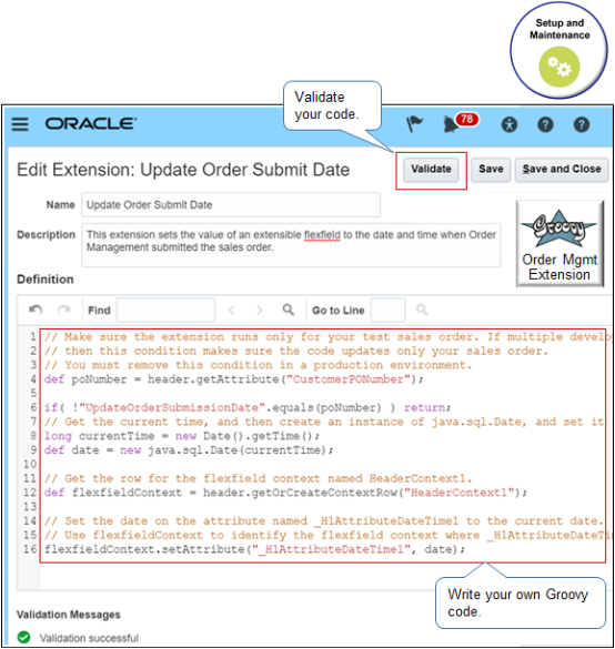

Here is some Groovy script in an example extension named Update Order Submit Date. It uses attribute _H1AttributeDateTime so it can set the value of an extensible flexfield to the date and time when Order Management submitted the sales order.
Extension That Modifies Order Management
