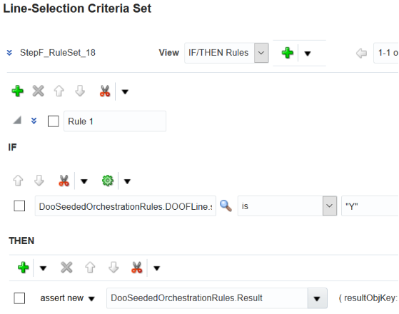

On the Edit Orchestration Process Definitions page, in the Process Details area, in the Step Definition list, locate the Ship Item row.
In the Ship Item row, in the Line Selection Criteria column, click Click for Rule.
In the Line Selection Criteria dialog, click Add Rule > Expand.
In the If area, click Left Value, expand DOOSeededOrchestrationRules > DOOFline, click ShippableFlag, then click OK.
In the Right Value attribute, enter
"Y"
. You must include the double quotation marks.
Create the Then Statement
You will create this Then statement.
assert new resultObjKey:DooSeededOrchestrationRules.DOOFLine.fulfillLineId
where
Assert New adds the result into the Result fact of the DooSeededOrchestrationRules dictionary.
resultObjKey is a property of Result. It specifies the fulfillment line to examine.
specifies to use the value of thefulfillLineId
attribute in the DOOFLine fact of DooSeededOrchestrationRules.
Create the Then statement.
In the Then area, click Add Action > Assert New.
Click Select a Target > DooSeededOrchestrationRules.Result.
Click Edit Properties.
In the Properties dialog, in the ResultObjKey row, click Value.
In the Condition Browser, enter
DOOFLine
, wait a moment, expand DooSeededOrchestrationRules.DOOFLine, clickFulfillLineId
, then click OK > OK. -
In the Line Selection Criteria dialog, click Validate, make sure the Validation Log that displays doesn't contain errors, then click Save.
On the Edit Orchestration Process Definition page, click Save.
