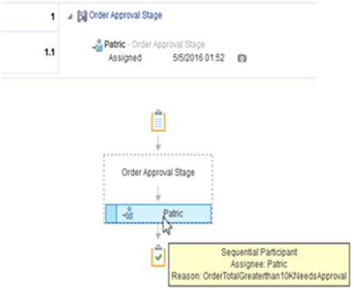

Test Your Set Up
  1. Make sure you have the privileges that you need to create sales orders, go to the Order Management work area, create a sales order, then click Submit.
    Attribute
    Value
    Customer
    Computer Service and Rentals
    Amount
    Add items to an order line so that the Amount exceeds $10,000.
  2. Verify that Order Management updates the order status to Approval Pending.
  3. Click View Approval Information, then verify the approval details reflect the approval rule you created.
    rule that includes approval information that reflects the approval rule that you created
  4. In a separate browser session, Make sure you have the privileges that you need to manage sales orders.
  5. Open the Pending Notifications page, locate the link for the approval request, such as Action Required: Approval Request for Order 258093, then click Approve.
  6. Navigate to the browser session for the Order Entry Specialist, refresh the page, then verify that the order status is now Processing.
