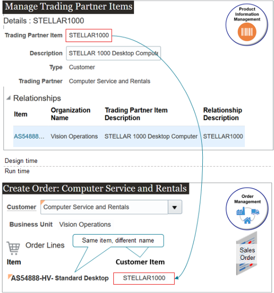

Assume you must create a relationship between the STELLAR1000 customer item and the AS54888 Oracle item.
Note
You use the Manage Trading Partner Items page in the Product Information Management work area to create a relationship between an Oracle item and your customer item. A customer item is a trading partner item where the Type equals Customer.
Order Management uses your set up from Product Information Management to determine which item to add to the order line.
Order Management gets the value from the Trading Partner Item attribute in Product Information Management and displays it in the Customer Item attribute on the order line.

Click Tasks > Manage Trading Partner Items.
On the Manage Trading Partner Items page, click Create Trading Partner Item (the plus icon).
In the Create Trading Partner area, set the values.
Attribute
Value
STELLAR1000
Description
STELLAR 1000 Desktop Computer
Type
Customer
Trading Partner
Computer Service and Rentals
Status
Active
Create a relationship between the STELLAR1000 and the AS54888.
Expand the Relationships area, then click Actions > Create.
In the Create Customer Item Relationship dialog, set the values, then click OK.

On the catalog line, search for STELLAR1000. You created a relationship for more than one item, and you set the Get and Set Values for Customer Items profile option to True, so verify that Order Management displays a dialog asking whether you want to select an instance.
In the dialog, click OK, then verify that Order Management adds the AS54888.
Verify that the order line includes the Customer Item attribute, and that the attribute contains STELLAR1000.
