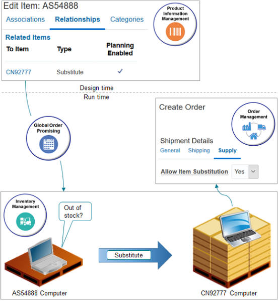

You can use the Substitute Item action or the Check Availability action in a fulfillment view of the Order Management work area to substitute an item. You can also use Global Order Promising to substitute an item. This topic describes how to use Global Order Promising.
      Note
            You use the Product Information Management work area to specify the item to substitute at design time.
            At run time, the Order Entry Specialist creates a sales order in the Order Management work area and clicks Submit.
            Fulfillment fulfills the item. -
                  The scheduling fulfillment task in your orchestration process calls Global Order Promising.
                  Global Order Promising communicates with Inventory Management to determine whether the item is out of stock.
                  If its out of stock, and if the Allow Item Substitution attribute on the sales order is Yes, and if Global Order Promising determines that the substitute item is available, then Global Order Promising sends a recommendation to Order Management to use it, and Order Management uses the substitute to fulfill the order line.

Assume you must set up substitution for the AS54888 Computer.
               If the AS54888 Computer isn't available in inventory, then substitute it with the CN92777 Computer.
Try it.
               Go to the Product Information Management work area.
               On the Product Information Management page, click Tasks > Manage Items.
               On the Manage Items page, search for your item. Attribute Value Item AS54888
               In the Search results, in the Item column, click AS54888.
               On the Edit Item page, click Relationships.
               In the Relationships area, click Actions > Create, set the values, then click OK. Attribute Value To Item CN92777 Computer Type Substitute Planning Enabled Contains a check mark.
               On the Edit Item page, click Save.

               Go to the Order Management work area and create a new sales order.
               Click Shipment Details > Supply, then set the value. Attribute Value Allow Item Substitution Yes
               Search for the AS54888 on the catalog line, notice that the line displays Out of Stock, then click Add.
               Notice that the order line contains the AS54888, then click Submit.
               Click Actions > Switch to Fulfillment View.
               Verify that Order Management replaced AS54888 with CN92777.
