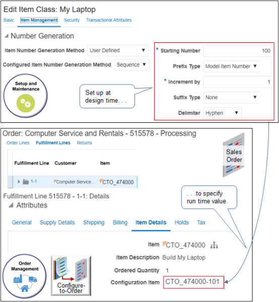

Set up the item class so that the item name for each configured item is unique. A unique name can be useful to help track and manage each item.
Here's what your setup looks like after you complete the procedure.
      Note
            You use the Edit Item Class page in the Setup and Maintenance work area to specify the number at design time.
            Order Management displays the number in the Configuration Item attribute on the sales order at runtime.
Let's say you need to add a suffix to the item name for each unique configuration of item CTO_474000. You need to start the suffix with the number 100, increment it by 1 each time a user orders the item, and use a hyphen (-) to separate the suffix from the name. For example, here's the name that the flow creates the first time the user adds the item.
CTO_474000-100where
            CTO_474000 is the name of the configured item
            - (the dash) is the delimiter
            100 is the starting number of your sequence
Here's the name for the next time a user adds the item.
CTO_474000-101The number is unique across order lines, sales orders, and users.

               On the Edit Item Class page, click Item Management, then set the values. Attribute Value Item Number Generation Method User Defined This means you, the administrator, defines numbering. Not the end-user who creates the sales order. Configured Item Number Generation Method Sequence
               In the Details area, set the values. Attribute Value Starting Number 100 Prefix Type Model Item Number Specify what displays before the starting number. Increment By 1 Suffix Type None Specify what displays after the starting number. Delimiter Hyphen Specify the character that separates the starting number from the prefix or the suffix.

               In the Attributes area, click Item Details, then notice that the value of the Configuration Item attribute is CTO_474000-100.
               Click the row that contains 2-1 in the Fulfillment Line column.
               Notice that the value of the Configuration Item attribute is CTO_474000-101.
