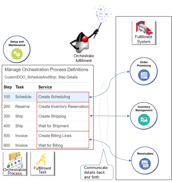

You set the task service on the orchestration process step.
Each service does a specific fulfillment task, such as Create Scheduling.
The service communicates a fulfillment request to an application in your fulfillment system. For example:
The Create Scheduling service communicates with Order Promising.
The Create Inventory Reservation, Create Shipping, and Wait for Shipment services communicate with Inventory Management.
The Create Billing Lines and Wait for Billing services communicate with Receivables.
Fulfillment systems communicate updates back to the services, such as status.
Communication happens through the interface.
You can set up other fulfillment systems. For details, see Overview of Integrating Order Management.
