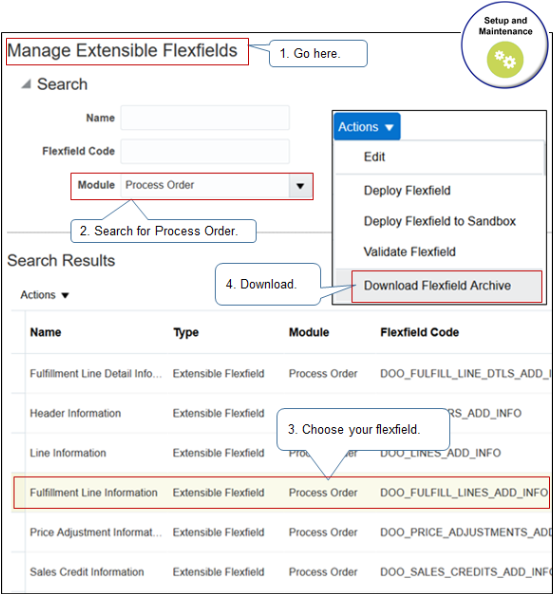

In the Setup and Maintenance work area, go to the task.
Offering: Order Management
Functional Area: Orders
Task: Manage Order Extensible Flexfields
On the Manage Order Extensible Flexfields page, in the Module attribute, search for Process Order.
Select your extensible flexfield.
Header Information
Fulfillment Line Information
Fulfillment Line Detail Information
Click Actions > Download Flexfield Archive.
Open the zip file that you downloaded and navigate to oracle/apps/scm/doo/processOrder/flex/myObjectContextsB/view/myVO.xml.

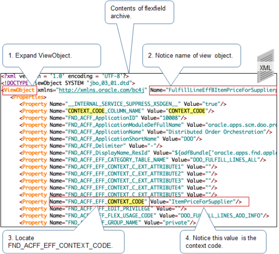

Examine Flexfield Archive
Note
Expand ViewObject.
Notice the value in the Name attribute of the view object. This is the name of the view object that you copy and paste into the View Object attribute of your service mapping.
The name in the screen capture above is truncated. The full name for this example is FulfillLineEffBItemPriceForSupplierprivateVO.
The name for the example earlier in this topic is HeaderEFFBComplianceDetailsprivateVO.
Under ViewObject, locate FND_ACFF_EFF_CONTEXT_CODE.
Notice the value of the context code. In this example, the value is ItemPriceForSupplier. You will use it later.

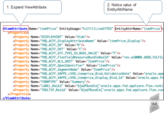

Expand ViewAttribute.
Notice the value of EntityAttrName. This is the name of the view object that you copy and paste into the attribute View Object Attribute of your service mapping. EntityAttrName for the example earlier in this topic would equal
_complianceInfo

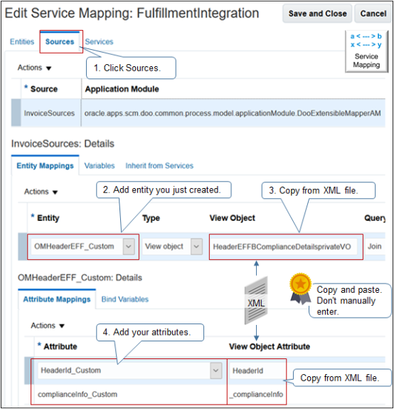

Specify Source
Note
Click Sources.
On the Entity Mappings tab, add your new entity, such as OMHeaderEFF_Custom.
Specify the view object.
Locate the view object name in the XML of the flexfield archive, copy it, then paste it into the View Object attribute. In this example, the view object name is HeaderEFFBComplianceDetailsprivateVO.
The values must match exactly, or your service mapping will fail. To avoid problems, use copy and paste. Don't manually enter it.
Add your attributes.
For each attribute you add, locate the view object attribute in the XML, copy it, and paste it into the attribute View Object Attribute. In this example, notice that the
_complianceInfo
view object attribute begins with an underscore because the XML also contains an underscore.

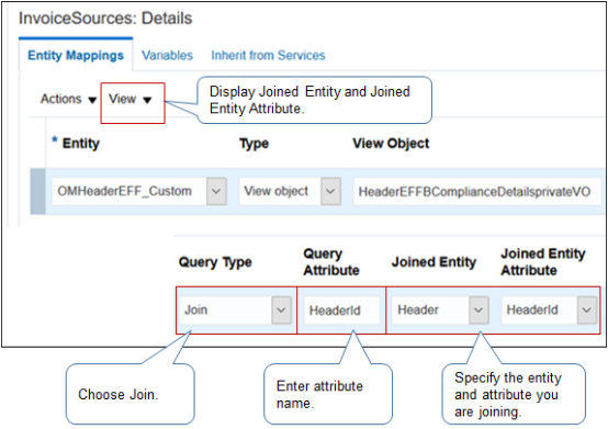

Add Entity
Here's some tips when you add the entity.
Before you add the entity, click View > Joined Entity > Joined Entity Attribute.
Set the values.
Attribute
Value
Query Type
Select Join.
Query Attribute
Enter the name of your attribute, such as HeaderId.
Joined Entity
Specify the entity you're joining, such as Header.
Specify the attribute in the entity you're joining, such as HeaderId.
