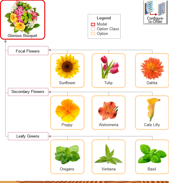

Assume you set up this assemble-to-order configuration model:

							options:Glorious Bouquet Focal Flowers Sunflower Tulip Dahlia Secondary Flowers California Poppy Alstroemeria Cala Lilly Leafy Greens Oregano Verbena BasilItalics indicate the options that you selected.
