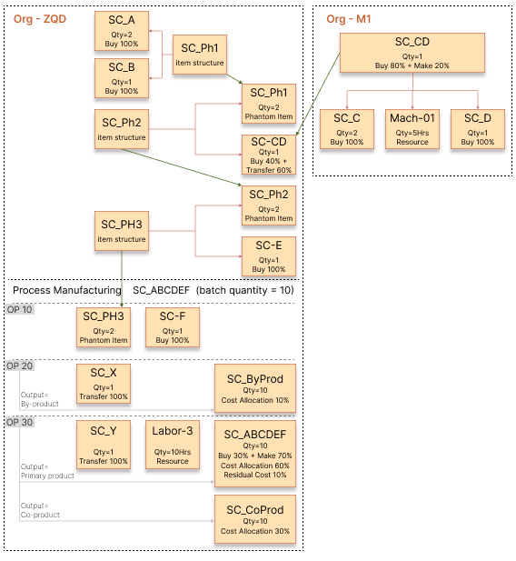

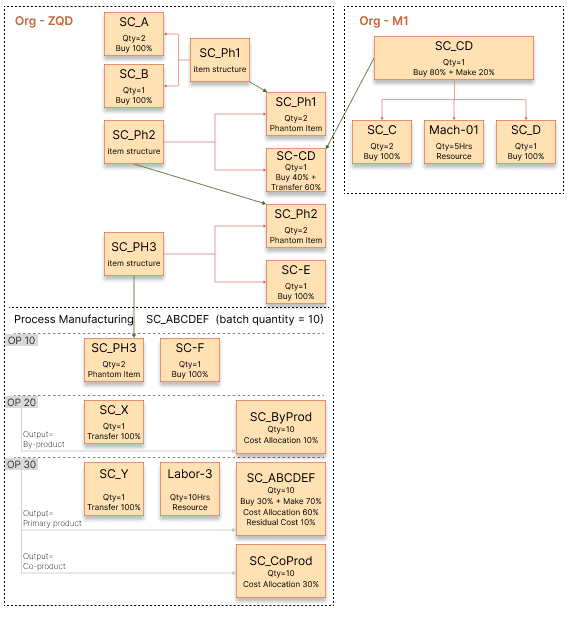

Here's an image illustrating the overall manufacturing flow for the finished item SC_FP01.
For this item, you create the work definitions.

Now, let's identify the costs involved in manufacturing the final product SC_ABCDEF in the ZQD organization.
| Operation Sequence | Component/Resource | Cost Element Type | Unit Cost | Quantity | Amount |
| 10 | SC_PH3 | 11467.20 | 2 | 22934.40 | |
| 10 | SC_F | Material | 4590.00 | 1 | 4590.00 |
| Overhead | 510.00 | 1 | 510.00 | ||
| 20 | SC_X | Material | 1000.00 | 1 | 1000.00 |
| Overhead | 100.00 | 1 | 100.00 | ||
| Overhead | 10% | 1 | 110.00 | ||
| 30 | SC_Y | Material | 1300.00 | 1 | 1300.00 |
| Overhead | 200.00 | 1 | 200.00 | ||
| Overhead | 10% | 1 | 150.00 | ||
| Labor-3 | Resource | 50.00 | 10 | 500.00 | |
| Plant overhead | Overhead | 20% | 918.00 | ||
| Plant overhead | Overhead | 4% | 1054.80 | ||
| Plant overhead | Overhead | 3% | 926.53 | ||
| Plant overhead | Overhead | 1.00 | 10 | 10.00 |
In the above table the overhead of 10% for SC_X and SC_Y is the transfer markup for these items from M1.
