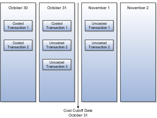

Scenario
Assume that the current date is November 2, and the cost cutoff date is October 31.
The following costed and uncosted transactions are in process.

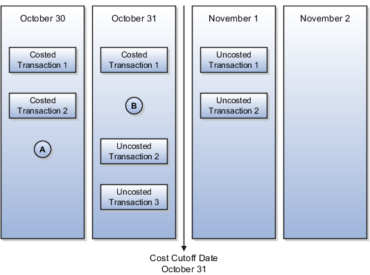

Example 1
Transactions are backdated to a point before the latest costed transaction.
In the following figure, the inventory transaction is backdated to position A. The transaction is costed with accounting date B before transactions 2 and 3 are processed. The transaction created on November 2 and backdated to October 30 is costed with the effective date of October 31.

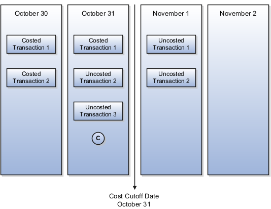

Example 2
Transactions are backdated to a point between the latest costed transaction and the cost cutoff date.
In the following figure, the inventory transaction is backdated to position C. The transaction is costed with accounting date C after transactions 2 and 3 are processed. The transaction created on November 2 and backdated to October 31 is costed with the effective date of October 31.

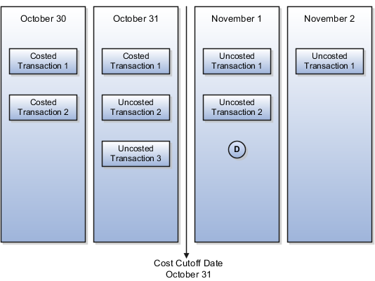

Example 3
Transactions are backdated to a point after the cost cutoff date.
In the following figure, the inventory transaction is backdated to position D. The transaction is costed with accounting date D after the cost cutoff is moved past October 31. The transaction created on November 2 and backdated to November 1 is costed with the effective date of November 1.
