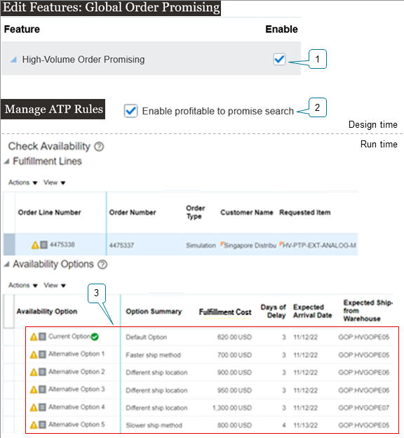

- Enable the High Volume Order Promising feature. Promising will include the cost that you incur to ship the item from the ship from location to your customer's site when you schedule the arrival date. You can also include a manufactured item’s resource cost and material cost from a bill of resources.
- Enable profitable to promise on your ATP rule. Use it so you can change the source that you would normally use to fulfill the item to a source that's more cost effective.
- At run time, use the Check Availability action to examine the default
availability option that Promising is currently using and alternative options
that might be more cost effective, for example, by using a different shipping
method or by shipping from a different location. Use the default, or select an
alternative.
For example, select from one of these:
Availability Option Option Summary Fulfillment Cost Days of Delay Expected Arrival Date Expected Ship From Warehouse Current Option Default Option $620 3 1/1/2023 Denver Alternative Option 1 Faster Ship Method $700 3 1/1/2023 Denver Alternative Option 2 Different Ship Location $900 3 1/1/2023 Seattle Alternative Option 3 Different Ship Location $950 3 1/1/2023 Portland Alternative Option 4 Different Ship Location $1,300 3 1/1/2023 San Francisco Alternative Option 5 Slower Ship Method $800 4 1/2/2023 Denver
Notice how the action prioritizes on time delivery over cost. For example, option 5 costs less than options 2, 3, and 4, but option 5 is last in the list because it adds another day of delay.

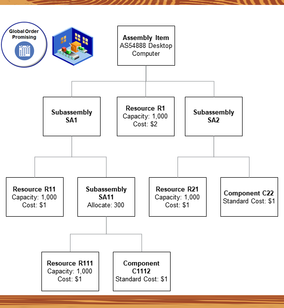

Example
Assume you have this supply chain network.
Assume
- You need to promise an order line for the AS54888 Desktop Computer item, with a quantity of 10.
- The AS54888 includes subassembly SA1 and subassembly SA2.
- You use the R1 resource to assemble SA1 and SA2.
- Capacity is for each day and cost is for each unit. For example, R1 can build 1,000 units each day at a cost of $2 for each unit.
- You make each subassembly from other subassemblies or manufacturing components, and you use different resources to assemble them.
- You build the subassemblies and the AS54888 in you factory.
- All manufacturing components and resources are available in the factory.
Resource or Manufacturing Component | Cost for Each Unit | Quantity | Total |
C22 | $1 | 10 | $10 |
C1112 | $1 | 10 | $10 |
R1 | $2 | 10 | $20 |
R21 | $1 | 10 | $10 |
R11 | $1 | 10 | $10 |
R111 | $1 | 10 | $10 |
- | - | Total Fulfillment Cost: | $70 |
Note
- Promising uses the critical manufacturing components and critical resources from the bill of resources.
- Promising looks at all possible paths through your supply chain, then gives you the least expensive path.
- Promising doesn't return the individual cost for any assembly or subassembly when you build the item. Instead, it returns the cost when it promises the AS54888 from your available to promise inventory after you finish building the item.

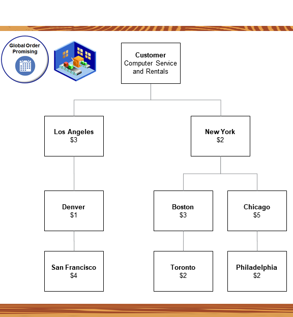

How Promising Examines Your Supply Chain Network
Example 1
Note
- You need to promise an order line that has a quantity of 20.
- The requested arrival date on the line is the system date.
- A quantity of 10 units are available on the requested arrival date at every organization in your network.
- You can split the line across factories but you must deliver the entire quantity together in a single shipment.
Promising will look at every node in your network until it has fulfilled the requested quantity.
Result | Supply Chain Path | Fulfillment Cost | Math |
Default | Los Angeles first, and then Denver | $40 |
Alternative 1 | New York first, and then Boston | $50 |
Note
- Promising will start with the default path, which is Los Angeles.
- If the Los Angeles path can't meet demand, then Promising will look at the New York path.
- The Los Angeles path costs less, so Promising will promise from Los Angeles.
Example 2
Assume the same scenario except with a quantity of 30.
Default | New York first, then Boston, then Toronto | $70 |
Alternative 1 | Los Angeles first, then Denver, then San Francisco | $80 |
Alternative 2 | New York first, then Chicago, then Philadelphia | $90 |
Note
- Promising will start with New York as the default path.
- If the New York path can't meet demand, then Promising will look at Boston because Boston is more cost effective than going through Philadelphia.
- If Boston can't meet demand, then Promising will look at the Los Angeles path because going through Los Angeles is more cost effective than going through Philadelphia.

Try It
- Set up your ATP rule.
- Go to the Global Order Promising work area.
- Click Tasks > Manage ATP Rules.
- Create a new rule or open one that you already have for editing, then
set the attributes.
Attribute Value Enable Profitable to Promise Search Contains a check mark.
You must enable this attribute.
Promising will assume this option is enabled for all organizations in your supply chain network, and will use this feature for all of those organizations.
- If you drop ship your item, then:
- Set the attribute.
Attribute Value Promising Mode Supply Chain Availability Search - Click ATP Rule Assignment, then set the
attribute.
Attribute Value Assigned to Organization Set this attribute to your drop ship validation organization.
- At run time, use the Check Availability action to examine your availability options. Use the default, or select an alternative.
