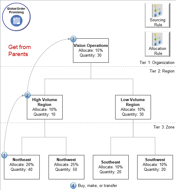

Get Supply from a Node's Parent
Set up a hierarchy that gets supply from a node's parent and distributes it to other nodes.
Assume you have this hierarchy, and you will get supply for the sales order from all three levels of the hierarchy.
Here's the sequence that Promising will use to allocate supply. It’s the same one that's in Use Lower Priority Supply to Fulfill Higher Priority Demand but with a few important differences:
Step Description Remaining Balance
1 You create a Sales Order in the Northeast node for the AS54888 computer with a quantity of 100, and Order Management populates the three attributes that you reference in your allocation hierarchy to All, High Volume, and Northeast. Promising consumes all 40 units of the supply that's available to allocate in the Northeast node, which is in the lowest level, first. 220 minus 40 equals 180.
2 Promising consumes the 10 units of supply that's available to allocate in Northeast's parent, High Volume Region. 180 minus 10 equals 170.
3 Promising still needs 170 units, so it consumes the 30 units that are available in High Volume's parent, Vision Operations. 170 minus 30 equals 140.
4 Promising still needs 140 more units to fulfill the 220 units on the fulfillment line, so it uses your ATP rules and sourcing rules to make, buy, or transfer the remaining 140 units. 140 minus 140 equals 0.

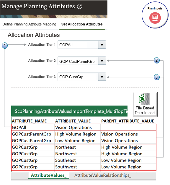

Specify the Hierarchy
  1. Go to the Plan Inputs work area, then click Tasks > Manage Planning Attributes.
  2. On the Define Planning Attribute Mapping tab, use the Create action three times to create these attributes.
    Attribute Name Planning Attribute Type Data Type
    GOPCustGrp Netting and Allocation Attribute Character
    GOPAll Netting and Allocation Attribute Character
    GOPCustParentGrp Netting and Allocation Attribute Character
    Leave the Oracle Fusion Value Set attribute empty.
  3. Click Set Allocation Attributes. Make sure you enabled the features earlier in this procedure. If you didn't, you won't see the Set Allocation Attributes tab.
  4. Set the values.
    Attribute Value
    Allocation Tier 1 GOPAll
    Allocation Tier 2 GOPCustParentGrp
    Allocation Tier 3 GOPCustGrp
  5. Click Save and Close.
    Promising automatically creates an attribute set named BM_Attr_Hrcy. You must use this value when you import. We'll show you how next.

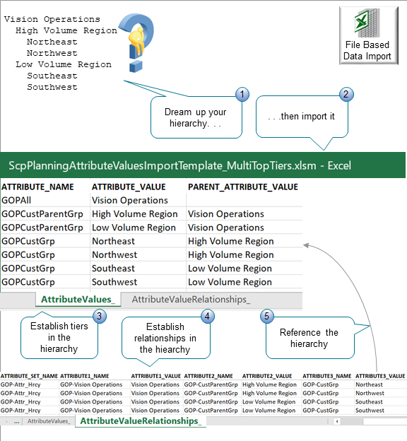

Import Your Data
You must use file-based data import to create your hierarchy. You can't use the promising or planning work areas to do this.
What the Numbers Mean
  1. Think about how the hierarchy that you'll need to prioritize and fulfill demand.
  2. Use file-based data import to import your thoughts into Oracle Applications.
  3. Use the AttributeValues tab to establish tiers in the hierarchy.
  4. Use the AttributeValueRelationships tab to establish relationships for each node in the hierarchy.
  5. Reference the hierarchy that you create on the AttributeValues tab.
Assume you need to create this hierarchy.
Vision Operations
  High Volume Region
    Northeast
    Northwest
  Low Volume Region
    Southeast
    Southwest
The text might be hard to read in the illustration, so here is the same data from the AttributeValues tab:
SR_INSTANCE_CODE ATTRIBUTE_NAME ATTRIBUTE_VALUE PARENT_ATTRIBUTE_VALUE
GOP GOPAll Vision Operations -
GOP GOPCustParentGrp High Volume Region Vision Operations
GOP GOPCustParentGrp Low Volume Region Vision Operations
GOP GOPCustGrp Northeast High Volume Region
GOP GOPCustGrp Northwest High Volume Region
GOP GOPCustGrp Southeast Low Volume Region
GOP GOPCustGrp Southwest Low Volume Region
Note these requirements for the AttributeValues tab. You must include:
  • A separate row for each node in the top tier of your hierarchy, a separate row each node in the middle tier, and a separate row for each node in the bottom tier. Each row establishes the relationships between all nodes in the hierarchy.
  • To specify a top level node, include the value GOPAll in the ATTRIBUTE_NAME column, and include the name of the top level node in the ATTRIBUTE_VALUE column, such as Vision Operations. GOPAll establishes the top tier. All the rows that have GOPAll will be part of your top tier.
  • To specify a node in the middle tier of your hierarchy, include the value GOPCustParentGrp in ATTRIBUTE_NAME, include the name of the node in ATTRIBUTE_VALUE, such as High Volume Region, and include the name of this row's parent in PARENT_ATTRIBUTE_VALUE, such as Vision Operations. GOPCustParentGrp establishes the middle tier. All the rows that have GOPCustParentGrp will be part of your middle tier.
  • To specify a node in the bottom tier of your hierarchy, include the value GOPCustGrp in ATTRIBUTE_NAME, include the name of the node in ATTRIBUTE_VALUE, such as Northeast, and include the name of this row's parent in PARENT_ATTRIBUTE_VALUE, such as High Volume Region. GOPCustGrp establishes the bottom tier. All the rows that have GOPCustGrp will be part of your bottom tier.
GOP, GOPAll, GOPCustParentGrp, GOPCustGrp are all example values. You don't have to use them. You can use whatever values you need to represent your supply chain.
Moving on, here is the data from the AttributeValueRelationships tab.
ATTRIBUTE_SET_NAME ATTRIBUTE1_NAME ATTRIBUTE1_VALUE ATTRIBUTE2_NAME ATTRIBUTE2_VALUE ATTRIBUTE3_NAME ATTRIBUTE3_VALUE
BM_Attr_Hrcy GOP-Vision Operations Vision Operations GOP-CustParentGrp High Volume Region GOP-CustGrp Northeast
BM_Attr_Hrcy GOP-Vision Operations Vision Operations GOP-CustParentGrp High Volume Region GOP-CustGrp Northwest
BM_Attr_Hrcy GOP-Vision Operations Vision Operations GOP-CustParentGrp Low Volume Region GOP-CustGrp Southeast
BM_Attr_Hrcy GOP-Vision Operations Vision Operations GOP-CustParentGrp Low Volume Region GOP-CustGrp Southwest
Note these requirements for the AttributeValueRelationships tab. You must include:
  • The value BM_Attr_Hrcy in the ATTRIBUTE_SET_NAME column, and you must include this value in each row that has data. BM_Attr_Hrcy means Backlog Management Attribute Hierarchy. Don't worry. We aren't using Backlog Management. We're using this value because we share this logic with other Oracle Applications, such as Oracle Backlog Management.
  • A separate row for each node in the bottom tier of your hierarchy. Each row establishes a relationship between the bottom node, that node's parent, and the bottom node's grandparent.
  • The name of the bottom node's grandparent in ATTRIBUTE1_VALUE, and preface it with the text GOP-. For example, GOP-Vision Operations.
  • The name of the top node in ATTRIBUTE1_VALUE, such as Vision Operations.
  • The value GOP-CustParentGrp in ATTRIBUTE2_NAME, and you must include this value in each row that has data.
  • The name of the bottom node's parent in ATTRIBUTE2_VALUE. For example, in the row that has Northeast in ATTRIBUTE3_VALUE, include the value High Volume Region in ATTRIBUTE2_VALUE.
  • The value GOP-CustGrp in ATTRIBUTE3_NAME, and you must include this value in each row that has data.
  • The name of a node that resides in the bottom tier in ATTRIBUTE3_VALUE, such as Northeast.
Try it.
  1. Download a copy of ScpPlanningAttributeValuesImportTemplate_MultiTopTiers.xlsm from the Supply Chain Planning chapter of File-Based Data Import (FBDI) for Oracle SCM.
    To get an XLS file that already has the data for this example, go to My Oracle Support, search for Technical Reference for Oracle Global Order Promising (Doc ID 2896893.1), then download the Example FBDI of an Allocation Hierarchy attachment.
  2. Add your data to the template, then click Generate CSV Files. The template will create three CSV files and save them, typically to the hard drive on the computer that you're using. Make a note of where the template saves them.
  3. Go to the Scheduled Processes work area, the search for the Load Interface File for Import scheduled process.
  4. In the Process Details dialog, set the parameters, then click Submit.
    Parameter Value
    Import Process Load Planning Data from Flat Files
    Data File
    Browse to the location that you noted earlier, then select AttributeValues.csv.
    Don't attempt to import AttributeValueRelationships.csv before you import AttributeValues.csv. If you do, the scheduled process will fail.
  5. Wait for the process to successfully finish.
  6. Repeat these steps, except import the AttributeValueRelationships.csv file.

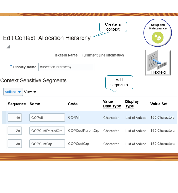

Create an Extensible Flexfield
  1. Add a context that has three segments to the predefined Fulfillment Line Information extensible flexfield.Fulfillment Line Information extensible flexfield. Add a context that has three segments
    Use these values.
    Sequence Name Code Value Data Type Display Type Value Set
    10 GOPAll GOPAll Character List of Values 150 Characters
    20 GOPCustParentGrp GOPCustParentGrp Character List of Values 150 Characters
    30 GOPCustGrp GOPCustGrp Character List of Values 150 Characters
    You will view this flexfield in the Order Management work area to see how Promising allocates supply on the order line.
    The context name that you use must match the context code that you specify on the Manage Contexts page. For details about this page and how to setup and deploy flexfields, see Overview of Using Extensible Flexfields in Order Management.

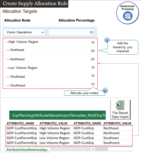

Create an Allocation Rule
You will add the nodes that you imported as a hierarchy, and then allocate each one of them.
get supply from the node parent
Try it.
  1. Go to the Order Promising work area.
  2. Click Tasks > Manage Supply Allocation Rules.

  6. In the Allocation Targets area, click Actions > Add Row to add each node.
    Allocation Node Allocation Percentage
    Vision Operations 15
    High Volume Region 10
    Northeast 20
    Northwest 25
    Low Volume Region 10
    Southeast 10
    Southwest 10
