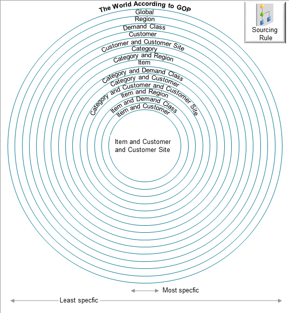

Assignment Levels for Global Sourcing Rules
Here are the levels for your global sourcing rules, listed from the most specific in row 1, to the least specific in row 15.
| Specificity | Assignment Level | Assign the Sourcing Rule When | Applies for All |
| 1 | Item and Customer and Customer Site | The fulfillment line has the item, the customer, and the customer site that you specify on the assignment. |
| 2 | Item and Customer | The fulfillment line has the item and the customer that you specify on the sourcing assignment. |
| 3 | Item and Demand Class | The fulfillment line has the item, and the sourcing rule's demand class matches the demand class that you specify on the assignment. |
| 4 | Item and Region | The fulfillment line has the item and the region that you specify on the assignment. |
| 5 | Category and Customer and Customer Site | The fulfillment line has the customer and customer site that you specify on the assignment, and the Product Category on the fulfillment line matches the category that you specify on the assignment. |
| 6 | Category and Customer | The fulfillment line has the customer that you specify on the assignment, and the Product Category on the fulfillment line matches the category that you specify on the assignment. |
| 7 | Category and Demand Class | The Product Category on the fulfillment line matches the category that you specify on the assignment, and the sourcing rule's demand class matches the demand class that you specify on the assignment. |
| 8 | Item | The fulfillment has the item that you specify on the assignment. |
| 9 | Category and Region | The Product Category on the fulfillment line matches the category that you specify on the assignment, and the fulfillment line has the region that you specify on the assignment. |
| 10 | Category | The Product Category on the fulfillment line matches the category that you specify on the assignment. |
| 11 | Customer and Customer Site | The fulfillment line has the customer and the customer site that you specify on the assignment. |
| 12 | Customer | The fulfillment line has the customer that you specify on the assignment. |
| 13 | Demand Class | The sourcing rule's demand class matches the demand class that you specify on the assignment. |
| 14 | Region | The fulfillment line has the region that you specify on the assignment. |
| 15 | Global | The fulfillment line, sourcing rule, or assignment doesn't have to have any specific value. |
Here's another way to visualize it.
