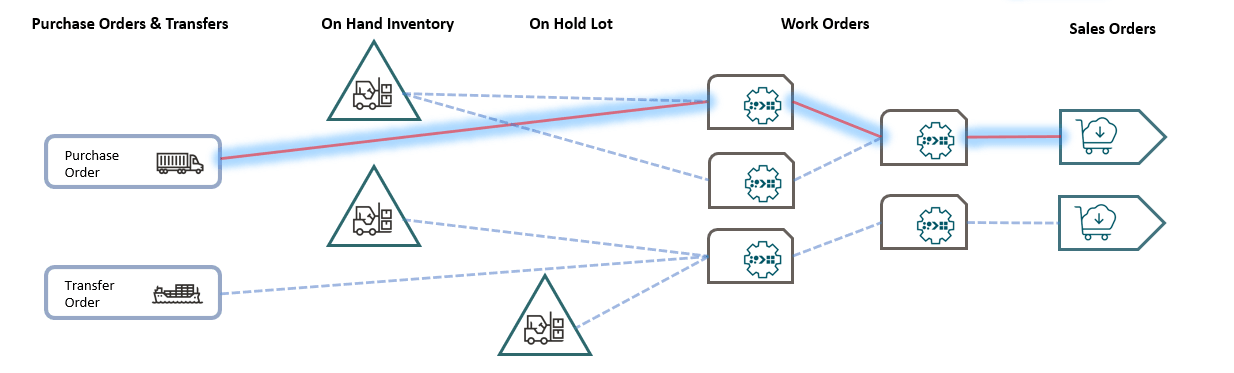

You can use REST API to get pegging information for a particular schedule. The pegging information is a supplier-consumer relationship between two business objects. For example, how to find which work order uses a specific purchase order.
The highlighted line represents the downstream pegging of the purchase order to the specific consuming work order. This information is very useful information for the scheduler. If the purchase order is delayed, the scheduler understands which work orders and other downstream demands are impacted. The entire lineage of downstream pegging can be fetched using this REST service.
The pegging depth indicates the level at which the downstream consumer is. The immediate consumer of the purchase order has a pegging depth of 1. The next consuming work order has a pegging depth of 2. Finally, the sales order is the end of the chain and has a pegging depth of 3.
Conversely, you can peg supply records upstream by a specific demand such as a sales order. The pegging depth is relative to the starting point of the query so immediate supply to the sales order has a pegging depth of 1. Working backwards, the pegging depth increments by 1 for each additional level of the pegging tree.
