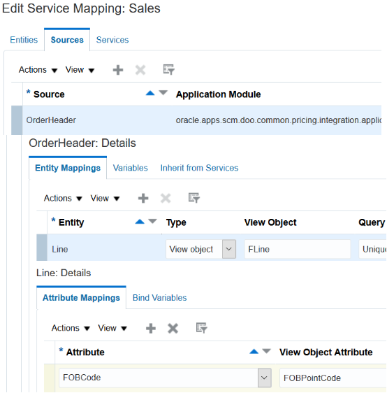

Map the attribute to the order header.
On the Edit Service Mapping page, click Sources, then click the row that includes the value.
Attribute
Value
Source
OrderHeader
In the OrderHeader Details area, on the Entity Mappings tab, click the row that includes the value.
Attribute
Value
Entity
Line
In the Line Details area, on the Attribute Mappings tab, click Actions > Add Row, then set the values.
Attribute
Value
Attribute
FOBCode
View Object Attribute
FOBPointCode
For example:
