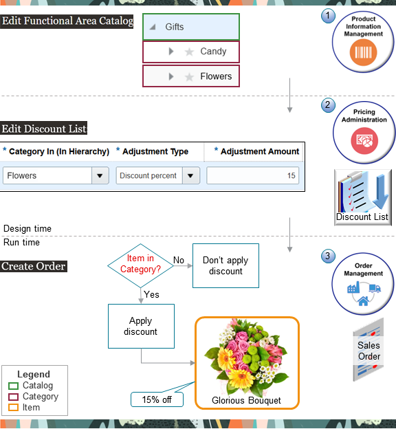

- Assume you use the Product Information Management work area to create a Gifts catalog, and it contains a child Candy category and a child Flowers category. Each child contains items. For example, Flowers contains the Glorious Bouquet item.
- You use the Pricing Administration work area to create a rule that applies a discount for each item that's in the Flowers category.
- At run time, you create a sales order in the Order Management work area, and Pricing applies your rule depending on whether the item is in the Flowers category. The Glorious Bouquet is in the Flowers category, so Pricing applies the 15% discount.

Assume you need to set up this rule:
If the item is the Glorious Bouquet, and if the item is in the
Flowers category of the Gifts catalog, then apply a 15%
discount.

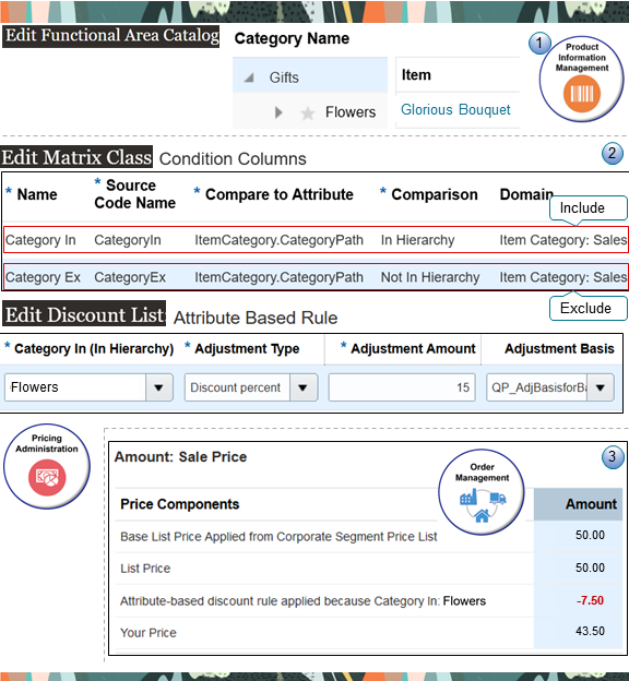

Manage the Matrix Class
- Sign out, then sign in with the privileges that you need to administer pricing.
- Go to the Pricing Administration work area, then click Tasks > Manage Matrix Classes.
- On the Manage Matrix Classes page, click Pricing Term Adjustment.
- On the Edit Matrix Class page, create the condition that you'll use to include
the item in the adjustment.
- in the Condition Columns area, click Actions > Add
Row, then set the values.
Attribute Value Name Category In Source Code Name CategoryIn Comparison In Hierarchy Compare to Attribute ItemCategory.CategoryPath - Click Save.
- In the Domain column, click the pencil, set the
values, then click OK.
Attribute Value Domain Type Item Category Catalog Gifts - Click Save.

- On the Edit Discount Lists page, in the Discount Rules area, click Actions > Create > Attribute Based Rule.
- In the dialog that displays, under Select Optional Condition Columns, add a check mark to Category In (In Hierarchy), then click OK.
- In the Create Discount Rule dialog, in the Attribute Based Rule area, click
Actions > Add Row, set the values, then click
OK.
Attribute Value Category In Flowers Adjustment Type Discount Percent Adjustment Amount 15 Adjustment Basis QP_AdjBasisforBaseListPrc - Click Access Sets, then set the value.

Attribute Value Business Unit Vision Operations Order Type Standard Orders - Search for the Glorious Bouquet item on the catalog line, then click the price.
- Examine the price breakdown in the Amount dialog. Verify that the breakdown
says:
Attribute-based discount rule applied because Category In: Flowers In Hierarchy Flowers
