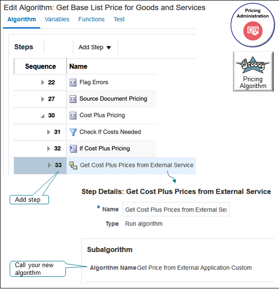

  1. Create a version of the pricing algorithm that you need to edit.
    • Click Tasks > Manage Algorithms under Pricing Configuration.
    • On the Manage Algorithms page, search for the pricing algorithm.
      Attribute
      Value
      Name
      Get Base List Price for Goods and Services
    • Click Actions > Create Version, locate the version that has this status, then open it for editing.
      Attribute
      Value
      Status
      In Progress
  2. Modify the test that you use to determine whether to process cost plus pricing.
    • On the Edit Algorithm page, in the Sequence column, expand step 15 in the tree, expand the Cost Plus Pricing step, then click the step that has the value.
      Attribute
      Value
      Name
      If Cost Plus Pricing
    • Delete the content in the Condition window and replace it with this code.
      Attribute
      Value
      Condition
      false && NeedsCostPlus && finer('==== Invoking Cost-Plus Pricing ====') == null
    • Click Save.
  3. Modify cost plus pricing.
    • Click the Cost Plus Pricing step.
    • Click Add Step > Composite Step > If.
    • Click the new step you just added and set the values.
      Attribute
      Value
      Name
      If External Costing Plus Pricing
      Condition
    • Click Save.
  4. Add the subalgorithm.
    • In the tree, click the triangle on the step you just added, If External Costing Plus Pricing.
      This helps to make sure that the subalgorithm you add is a child of If External Costing Plus Pricing.
    • Click Add Step > Subalgorithm.
    • In the Step Details area, set the values.
      Attribute
      Value
      Name
      Compute Cost from External Systems
      Algorithm Name
      Get Price From External Application Custom
      This is the algorithm that you created in the previous section in this topic.
    • In the Input Variables area, set the values.
      Attribute
      Value
      Variable
      PriceRequest
      Assignment Value
      PriceRequest
    • In the Output Variables area, set the values.
      Attribute
      Value
      Variable
      PriceRequest
      Assignment Value
      PriceRequest
  5. Click Save and Close, then publish the highest version of Get Base List Price for Goods and Services.

  • Save and publish your changes.
Calculate Margin
As an option, you can calculate margin according to costs from Oracle Costing.
The Calculate Cost pricing algorithm calculates cost, and the Calculate Margin step in the Calculate Pricing Charges algorithm calculates the margin. This section describes some guidelines you can follow for this use case.
