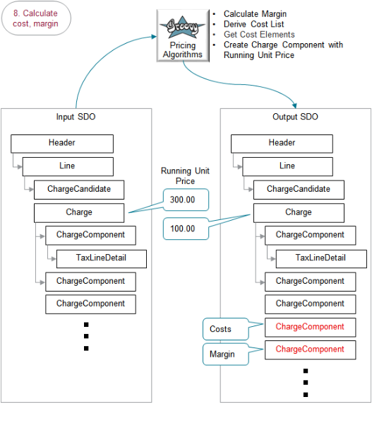

Now let's get back to our example. Here are the SDOs.
Note
The output SDO from the Calculate Tax step provides the input SDO.
The running unit price on the input SDO is 300 USD.
The running unit price on the output SDO is 100 USD.
Here's what the algorithms do.

Here are details about attributes in the SDOs.
Entity |
Attributes in Input SDO |
Attributes in Output SDO |
ChargeComponent (for the costs) |
Unit Price is the amount of the cost. |
ChargeComponent (for the margin) |
Unit Price is the margin. |
