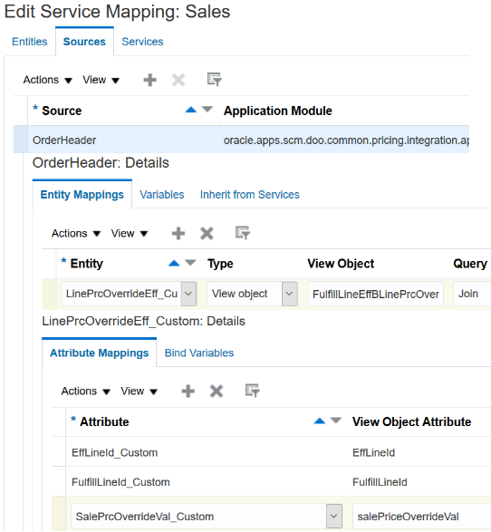

  5. Set up the source for the order header.
    • Click Sources, then click the row that includes the value.
      Attribute
      Value
      Source
      OrderHeader
    • On the Entity Mapping tab, click View > Columns, then add a check mark to Joined Entity and Joined Entity Attribute.
    • Click Actions > Add Row, set the values, then click Save.
      Attribute
      Value
      Entity
      LinePrcOverrideEff_Custom
      Type
      View Object
      View Object
      FulfillLineEffBLinePrcOverrideprivateVO
      Make sure the value you enter matches exactly the value you noticed earlier in this topic when you examined the flexfield archive. Don't include the .xml extension.
      Query Type
      Join
      Query Attribute
      FulfillLineId
      Joined Entity
      Line
      It might be necessary to click another row, and then return to this row to get the joined entity attributes to populate values.
      LineId
    • In Details area LinePrcOverrideEff_Custom, add the attributes, then click Save.
      Attribute
      View Object Attribute
      EffLineId_Custom
      EffLineId
      FulfillLineId_Custom
      FulfillLineId
      SalePrcOverrideVal_Custom
      salePriceOverrideVal
      Make sure the value you enter matches exactly the value you noticed in tag ViewAttribute Name of the flexfield archive you examined earlier in this topic. For example, ViewAttribute Name="salePriceOverrideVal".
      This step sets up Pricing to read extensible flexfield values from the public view object that Order Management sends to Pricing when the Order Entry Specialist uses the Price Order action or saves the sales order.
      For example:

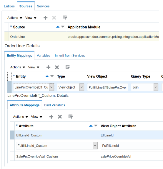

  6. Set up the source for the order line.
    • In the Sources area, click the row that includes the value.
      Attribute
      Value
      Source
      OrderLine
    • On the Entity Mapping tab, click Actions > Add Row, set the values, then click Save.
      Attribute
      Value
      Entity
      Type
      View Object
      View Object
      Query Type
      Join
      Query Attribute
      FulfillLineId
      Joined Entity
      Line
      LineId
      This step maps the extensible flexfield attributes in the public view object. It sets up Pricing to read extensible flexfield values from the public view object that Order Management sends to Pricing when Order Management updates the line quantity or shipping attributes on the order line.
    • In the Details area for HeaderPricingEff_Custom, add the attributes.
      Attribute
      EffLineId_Custom
      EffLineId
      FulfillLineId
      Make sure the value you enter matches exactly the value you noticed in the ViewAttribute Name tag of the flexfield archive you examined earlier in this topic. For example, ViewAttribute Name="salePriceOverrideVal".
      This step sets up Pricing to read extensible flexfield values from the public view object that Order Management sends to Pricing when Order Management updates the quantity attribute or a shipping attribute on the order line.
      For example:
      step that configures Pricing to read extensible flexfield values from the public view object that Order Management sends to Pricing when Order Management updates the quantity attribute or a shipping attribute on the order line

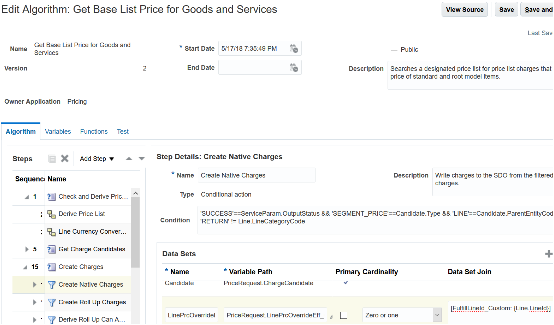

  5. On the Edit Algorithm page, on the Algorithm tab, expand step Create Charges, then click step Create Native Charges.
    You will modify this step so it references the extensible flexfield that contains the override value.
  6. In the Data Sets area, add this data set.
    Attribute
    Value
    Name
    LinePrcOverrideEff
    Variable Path
    PriceRequest.LinePrcOverrideEff_Custom
    Cardinality
    Zero or one
    Data Set Join
    [FulfillLineId_Custom: {Line.LineId}]
    For example:
    step that references the extensible flexfield that contains the override value

  9. Click the Create Charge Components step.
    You will modify this step so it references the extensible flexfield that contains the override value, then use this value to calculate the unit price.
  10. In the Data Sets area, add this data set.
    Attribute
    Value
    Name
    LinePrcOverrideEff
    Variable Path
    Cardinality
    Zero or one
    Data Set Join
