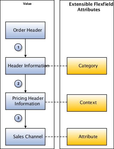

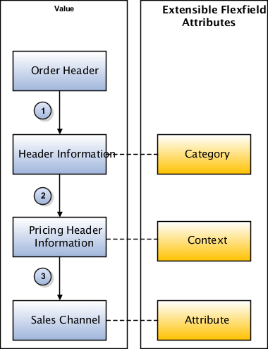

Define the Extensible Flexfield
Here's the hierarchy you define for your extensible flexfield.
Note
Reference |
Description |
1. The Order Header references the Header Information flexfield category. |
Not applicable |
2. The Header Information flexfield category references the Pricing Header Information flexfield context. |
A category is an organizing structure that you use to dynamically display different sets of pages and contexts at run time. In this example, you create a single category for a flexfield so Order Management displays the same extensible flexfield context for each sales channel. |
3. The Pricing Header Information flexfield context references the Sales Channel attribute. |
An extensible flexfield context is a group of attributes that you use to arrange segments into meaningful groups. For example, the Order Management work area displays each context in the same area on a page at run time. |

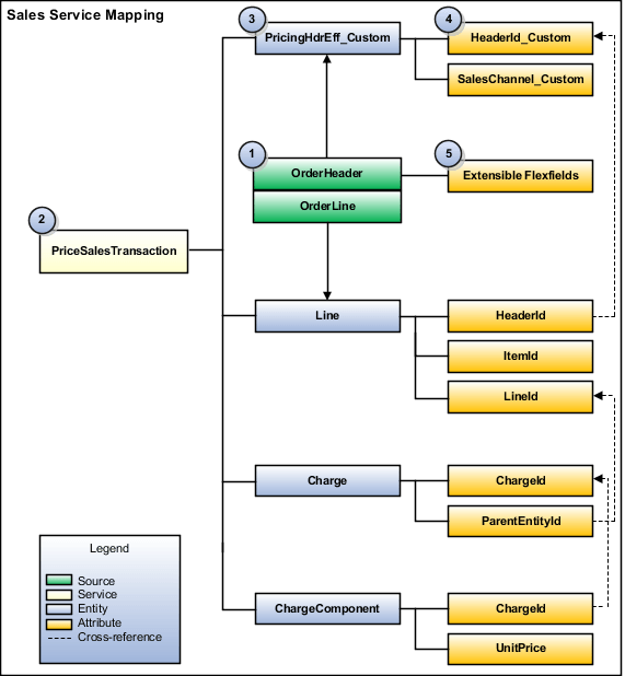

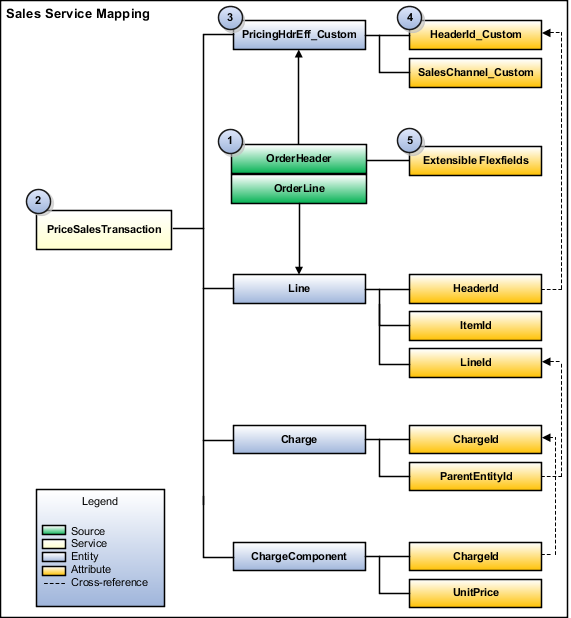

Administer the Service Mapping
Administer the service mapping that implements this SDO.
Here are the objects that this SDO contains.
Object |
Your Work in This Example |
1. Source. Provides a structure so Pricing can model data in the input SDO. |
You specify the OrderHeader source on the predefined Sales service mapping. You map this source to the PricingHdrEff_Custom entity, then map the SalesChannel_Custom and HeaderId_Custom attributes to this entity. |
2. Service. Requests the service mapping and receives the output SDO. |
The PriceSalesTransaction service references the entities and attributes that the pricing algorithm uses to calculate the product price of each sales order. |
3. Entity. References the entities that the service mapping requires to structure the output SDO. |
You add the PricingHdrEff_Custom entity to the Sales service mapping. |
4. Attribute. References the attributes that the service mapping requires to structure the output SDO. |
You add the HeaderId_Custom attribute and SalesChannel_Custom attribute. |
5. Extensible flexfields. Contains the data that this example uses. |
You map the extensible flexfields that you created earlier in this topic. You map them as attributes of the PricingHdrEff_Custom entity on the OrderHeader source. |
Learn about SDOs. For details, see How Service Mappings, Pricing Algorithms, and Matrixes Work Together.

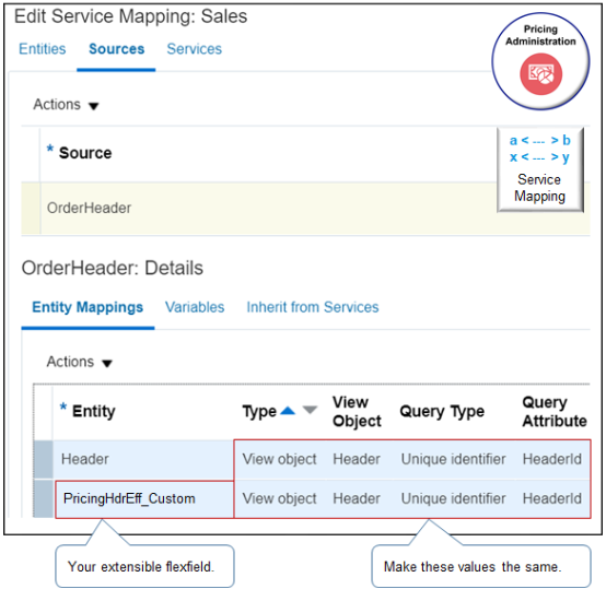

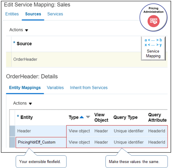

Specify the sources.
Click Sources, then click the row that contains this value.
Attribute
Value
Source
OrderHeader
In the OrderHeader Details area, click Actions > Add Row, set the \values, then click Save.
Attribute
Value
Entity
Type
View Object
View Object
PricingHeaderInformation
Make sure the value you enter for View Object matches the value from the Code attribute on the Create Context page you used when you created the extensible flexfield earlier in this topic.
Query Type
Unique Identifier
Query Attribute
HeaderId
Make sure the value you enter for Query Attribute matches the name you used earlier in this topic when you defined the entity for the extensible flexfield.
