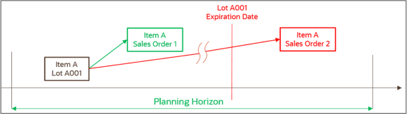

Items with Expired Lots
The planning process generates an Items with Expired Lots exception when it detects a potential expired lot. Item lots can satisfy demands before their expiration dates. A potential expired lot:
               Has a lot expiration date during the planning horizon.
               Isn't pegged to a demand that results in its use before its lot expiration date.
This exception occurs against items under full lot control.
In addition to reporting this exception, the planning process plans for you to flush the inventory on its lot expiration date. This process prevents you from using the lot after its lot expiration date to satisfy demands.
The calculation for Items with Expired Lots is: Lot Receipt Date + Shelf Life Days
In the following example, lot A001 of item A can only satisfy sales order 1 with a due date before the lot A001 expiration date.
         To see all items with expired lots in your constrained supply plan, follow these steps:
