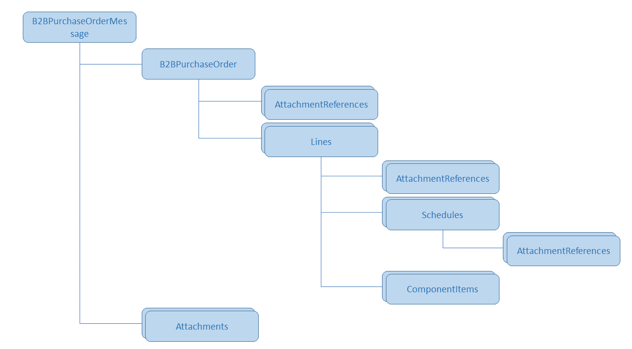

Figure 1 shows the structure of the payload that's received from the customer for the predefined message definition Oracle-1-0-B2B-Purchase-Order-In.
Figure 1

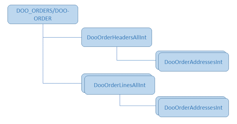

Figure 2 shows the structure of the transformed payload that is sent to the application for the predefined message definition Oracle-1-0-B2B-Purchase-Order-In.
Figure 2

<n1:AddressLine3></n1:AddressLine3>
<n1:City>CHATTANOOGA</n1:City>
<n1:County></n1:County>
<n1:StateOrProvince>TN</n1:StateOrProvince> <!-- STATE -->
<n1:PostalCode>37401</n1:PostalCode>
<n1:CountryCode>US</n1:CountryCode> <!-- COUNTRY_CODE -->
<n1:ContactName>Jimmy Anderson</n1:ContactName>
</n1:ShipTo>
<n1:OrderQuantity>2</n1:OrderQuantity>
<n1:RequestedShipDate>2020-08-28T14:10:10Z</n1:RequestedShipDate>
</n1:Schedules>
</n1:Lines>
</n1:B2BPurchaseOrder>
</n1:B2BPurchaseOrderMessage>
