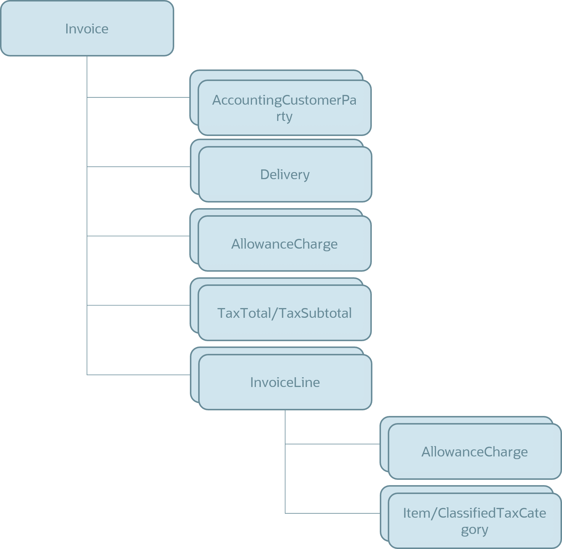

This diagram shows the structure of the inbound payload that's received from the inbound UBL-2.1-PEPPOL-Invoice-In message.
Structure of the inbound payload

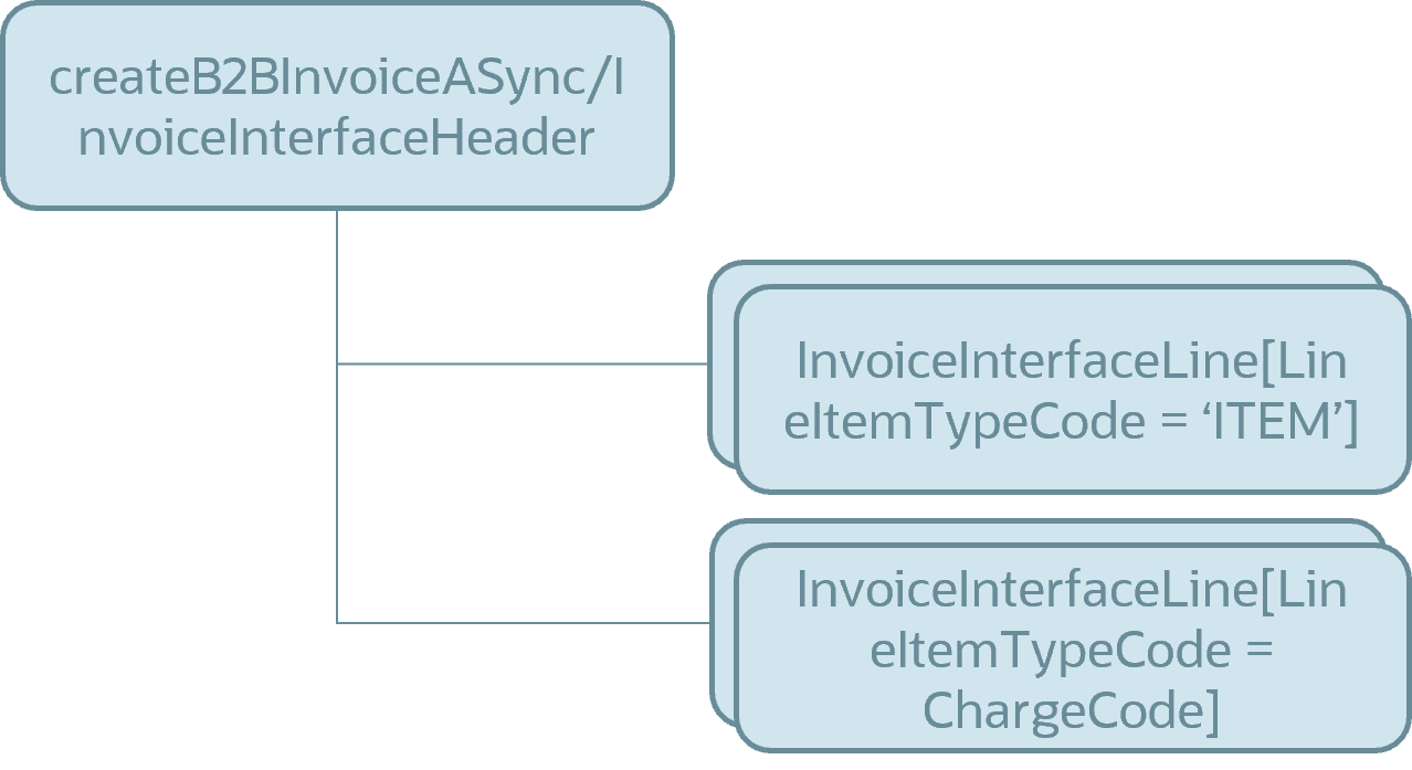

This diagram shows the structure of the payload that's passed to the application server for the UBL-2.1-PEPPOL-Invoice-In message.
Structure of payload passed to application server
