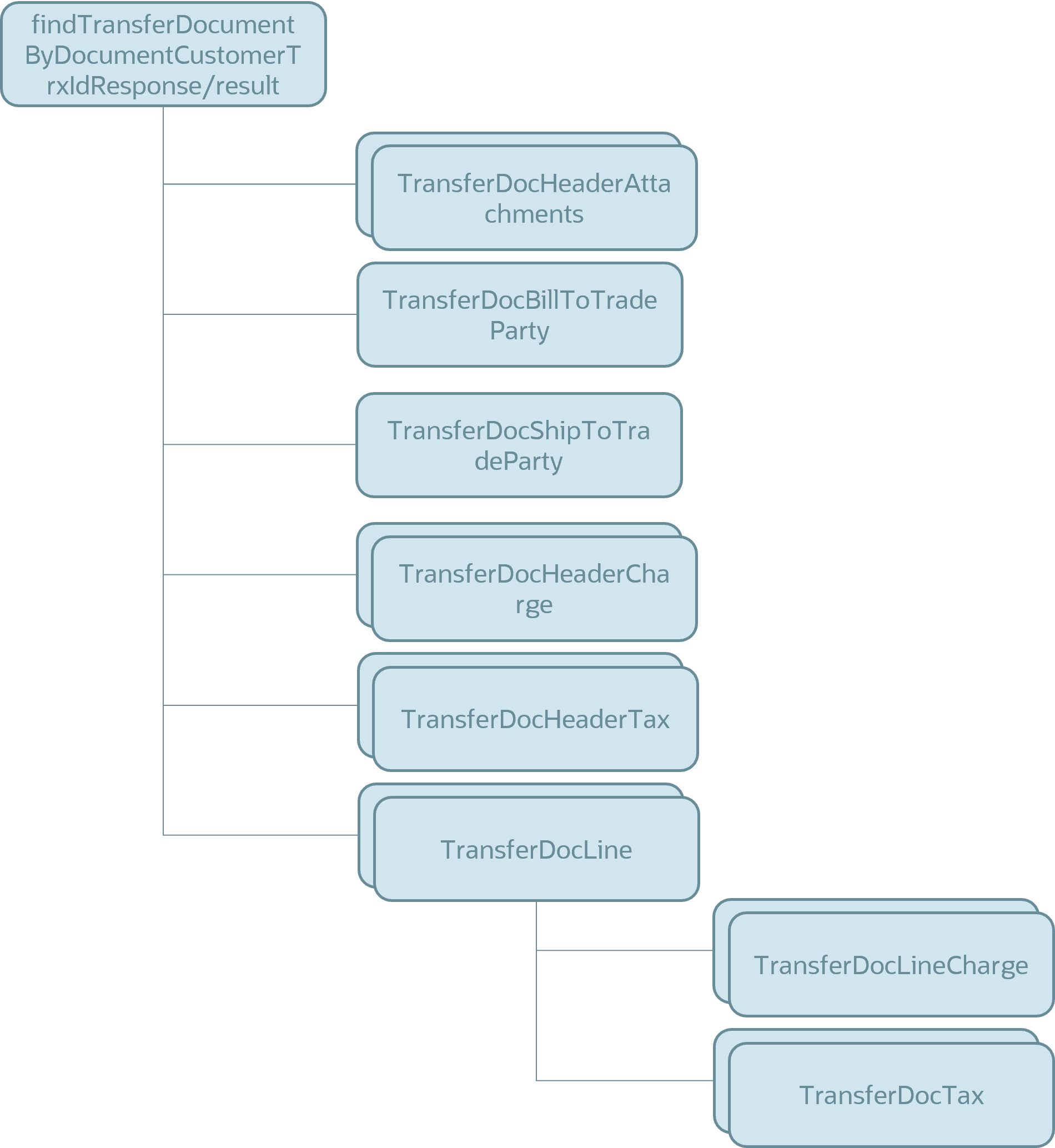

Figure 1
Figure 1 shows the structure of the inbound payload that’s received from the application.

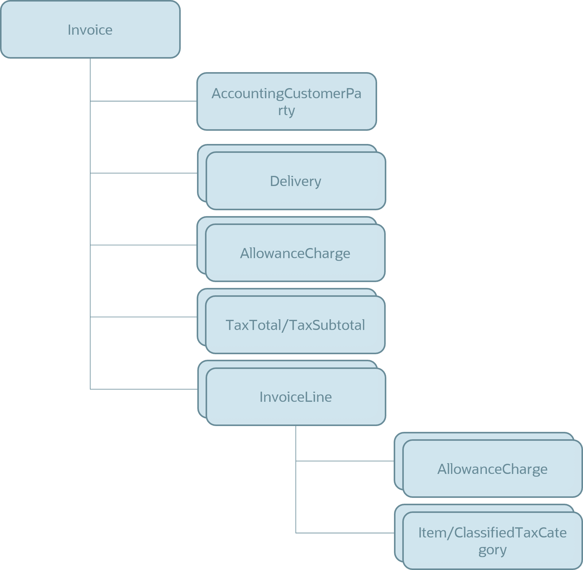

Figure 2
Figure 2 shows the structure of the UBL-2.1-PEPPOL-Invoice-Out payload that’s sent to
the customer.
