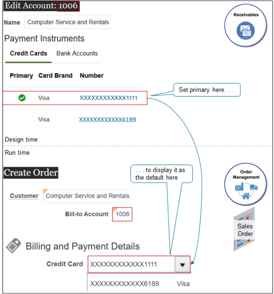

  • You add a credit card to the account in the Accounts Receivable work area.
  • You can set the card as the primary card when you add it.
  • At run time, Order Management selects and displays the primary card, by default. It also makes the other cards that you add in the Accounts Receivable work area available on the sales order.

  6. On the Edit Account page, in the Payment Instruments area, in the Credit Cards list, click Create a Credit Card. Its the icon that looks like a page.

    Notice that this is the same value you clicked on the Manage Customers page.

  4. Verify that the attribute value defaults to the primary card.
    Attribute
    Value
    Credit Card
    XXXXXXXXXXXX1111
