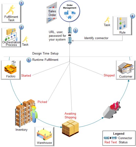

Assume you need to integrate Order Management with your shipment system. Use this topic to learn how.
An external fulfillment system is a fulfillment system that resides outside of Oracle Applications. Here's an example of how you set up the integration.
Note
You will specify status values and status conditions on your fulfillment task according to the values that your fulfillment system uses. You also specify the web services to use when communicating status.
Set up shipping steps on your orchestration process so they call your fulfillment system through the fulfillment task and task type that you set up for your integration. Modify status values and conditions on the orchestration process so they meet your integration requirements.

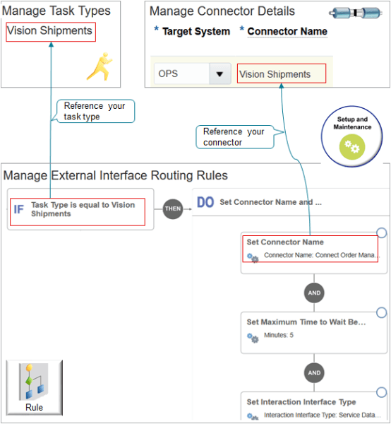

Set up a connector that includes the URL to your fulfillment system and any sign in requirements, such as user and password. Order Management uses the connector to find your fulfillment system and communicate with it.
Set up a routing rule that routes calls from your fulfillment system to the connector according to the task type that you specify.
At run time, Order Management and your fulfillment system use the connector to communicate status updates throughout the fulfillment lifecycle, such as Started, Picked, Awaiting Shipping, and Shipped.
Summary of the Steps

Manage Task Types
To start, you create task type, task, and services so you can reference them later in this procedure when you set up the orchestration process.
Try it.
Go to the Setup and Maintenance work area, then go to the task:
Offering: Order Management
Functional Area: Orders
Task: Manage Task Types
On the Manage Task Types page, click Actions > Add Custom, set values, then click Save.

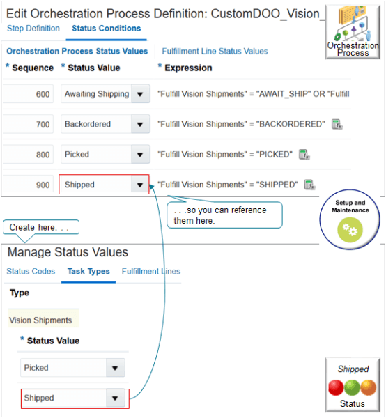

Manage Status Values
Create status values on the Manage Status Values page so you can reference them when you set up the orchestration process.
Note
Add status values on the Manage Status Values Page.
Later in this procedure, reference your status value on each orchestration process step.
For details, see Fulfillment Tasks.
Try it.
Task: Manage Status Values
On the Manage Status Values page, click Task Types, click Query by Example, enter
Vision Shipmentsin the Type column, then press the Enter key. -
In the Status Values area, notice that the Setup and Maintenance work area automatically created a set of status values for you when you created the Vision Shipments task type.
Status Value
Split Priority
Change Pending
10
Not Started
20
Started
30
Various
39
Completed with Various Statuses
50
User Action Required
60
Awaiting Response
110
Not Applicable
900
Cancellation Pending
970
Canceled
990
These values match what Order Management uses. You can add, delete, or modify them to accommodate your fulfillment system, as necessary. In general, we recommend that you keep these statuses so your fulfillment system is synchronized with statuses in Order Management, but you can add more.
For example, here's the same set of statuses but with a few new ones that Vision Shipments uses. The bold statuses are new. This way, Vision Shipments can communicate its statuses, such as Awaiting Fulfillment or Awaiting Fulfillment Line Aggregation, to Order Management and Order Management can display them in the Order Management work area, or you can reference them in your other set ups, as necessary.
Status Value
Split Priority
2
5
Change Pending
20
Not Started
30
Started
40
Various
60
Partially Picked
70
Partially Backordered
80
Picked
90
Backordered
100
Shipped
110
Canceled
120
Not Applicable
130
140
Awaiting Shipping
150
Awaiting Response
160
170
180

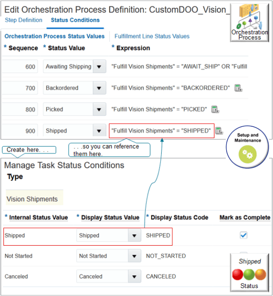

Manage Status Conditions
Create status values on the Manage Task Status Conditions page so you can reference them when you set up the orchestration process.
Task: Manage Task Status Conditions
On the Manage Task Status Conditions page, click Query by Example, enter
In the Status Conditions area, notice that the Setup and Maintenance work area automatically created a set of conditions for you when you created the Vision Shipments task type.
Internal Status Value
Internal Status Code
Display Status Value
Display Status Code
Awaiting Response
AWAIT_RESPONSE
Awaiting Response
AWAIT_RESPONSE
Canceled
CANCELED
Canceled
CANCELED
CANCEL_PENDING
CANCEL_PENDING
Change Pending
CHANGE_PENDING
Change Pending
CHANGE_PENDING
COMPLETED_VAR
COMPLETED_VAR
Not Applicable
NOT_APPLICABLE
Not Applicable
NOT_APPLICABLE
Not Started
NOT_STARTED
Not Started
NOT_STARTED
Started
STARTED
Started
STARTED
USER_ACTION
USER_ACTION
Various
VARIOUS
Various
VARIOUS
As with the status values, these status conditions match what Order Management uses. You can add, delete, or modify them to accommodate your fulfillment system, as necessary.
Here's the same set with some new conditions. The bold conditions are new. Make sure only the Shipped status contains a check mark in the Mark as Complete column.
Display Status Code
AWAIT_FULFILLMENT
AWAIT_FULFILLMENT
AWAIT_FLINE_AGGREGATE
Awaiting Response
AWAIT_RESPONSE
Awaiting Response
AWAIT_RESPONSE
Awaiting Shipping
AWAIT_SHIPPED
Awaiting Shipping
AWAIT_SHIPPED
Backordered
BACKORDERED
Backordered
BACKORDERED
Canceled
CANCELED
Canceled
CANCELED
CANCEL_PENDING
CANCEL_PENDING
Change Pending
CHANGE_PENDING
Change Pending
CHANGE_PENDING
COMPLETED_VAR
COMPLETED_VAR
Not Applicable
NOT_APPLICABLE
Not Applicable
NOT_APPLICABLE
Not Started
NOT_STARTED
Not Started
NOT_STARTED
Partially Picked
PARTIAL_PICK
Partially Picked
PARTIAL_PICK
Picked
PICKED
Picked
PICKED
Shipped
SHIPPED
Shipped
SHIPPED
Started
STARTED
Started
STARTED
USER_ACTION
USER_ACTION
Various
VARIOUS
Various
VARIOUS

Click Status Conditions, then, on the Orchestration Process Status Values tab, verify values in the Expression column.
Sequence
Status Value
Expression
600
Awaiting Shipping
"Fulfill Vision Shipments" = "AWAIT_SHIP" OR "Fulfill Vision Shipments" = "VARIOUS"
700
Backordered
"Fulfill Vision Shipments" = "BACKORDERED"
800
Picked
"Fulfill Vision Shipments" = "PICKED"
900
Shipped
"Fulfill Vision Shipments" = "SHIPPED"
1200
Partially Picked
"Fulfill Vision Shipments" = "PARTIAL_PICK"
1300
"Fulfill Vision Shipments" = "PARTIAL_BACK"
Make sure you verify the correct rows. For example, several rows contain the Awaiting Shipping status value, but you must verify only row 600.
If you don't have these values, then modify the expression, as necessary. For example, if you must modify row 600.

Add Status Values for the Fulfillment Line
Click Fulfillment Line Status Values, then click Edit Status Rule Set.
On the Edit Status Rule Set page, verify values.
Sequence
Status Value
Expression
1200
Awaiting Shipping
1300
Backordered
1400
Picked
1500
Shipped
1800
Partially Picked
1900
Click Actions > Add Row, then set the values.
Sequence
Status Value
Expression
1930
"Fulfill Vision Shipments" = "AWAIT_FULFILLMENT"
Click Actions > Add Row, set the values, then click Save and Close.
Sequence
Status Value
Expression
1960
"Fulfill Vision Shipments" = "AWAIT_FLINE_AGGREGATE"

Set Up Connector
Task: Manage External Interface Web Service Details
For details about how to set up a connector, see Overview of Connecting Order Management to Your Fulfillment System.
On the Manage Connector Details page, click Actions > Add Row, set the values, then click Save and Close.
Attribute
Value
Target System
OPS
OPS means Order Orchestration and Planning.
Connector Name
Vision Shipments
Connector URL
Enter the URL that locates your fulfillment system.
Connector Description
Connect Order Management to the Vision Shipments fulfillment system.
User Name
Name of a user you have set up on your fulfillment system.
Password
Password you need to access your fulfillment system.
Invocation Mode
Synchronous Service
Set Up Routing Rule
Create a routing rule that routes the fulfillment request to your connector according to task type.
Note
Reference the task type that you created on the Manage Task Types page when you create the If statement.
Reference the connector that you created on the Manage Connector Details page when you set the connector name in the Do statement.
Try it.
Task: Manage External Integration Routing Rules for Sales Orders
For details about how to set up a routing rule, see Use Visual Information Builder.
On the Manage External Interface Routing Rules page, click Create New Rule.
Set the values, then click Save and Close.
Attribute
Value
Name
Route Sales Orders to the Vision Shipments Fulfillment System
Create the If statement.
If Task Type is equal to Vision Shipments -
Create the Then statements.
Set Connector Name to Vision Shipments Set Maximum Time to Wait Before Allowing Cancel to 5 Minutes Set Interaction Interface Time to Service Data Object
