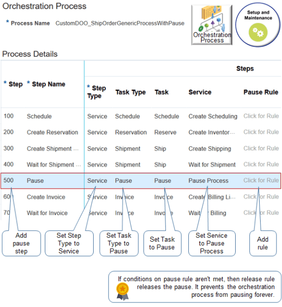

Add Step That Has a Pause Task
Add a step that references a pause task.
Note
  • Use the Edit Orchestration Process Definition page in the Setup and Maintenance work area.
  • Add a pause step. Set these values:
    Attribute
    Value
    Step Type
    Service
    Task Type
    Pause
    Task
    Pause
    Service
    Pause Process
  • Click the link in the Pause Rule column to set up your release rule.

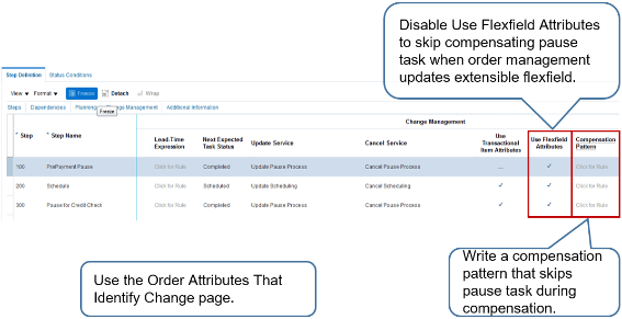

Pause When Revising Sales Orders
Pause when the Order Entry Specialist revises a sales order. You can set attributes that control this behavior.
Pause Task That Happens When Revising Sales Orders
Note
  • If your pause task doesn't reference an extensible flexfield, then disable the Use Flexfield Attributes option to instruct the orchestration process to skip the pause step when the value in an extensible flexfield changes.
  • If you don't need to run your pause task when revising a sales order, then write a compensation pattern.
    Assume you write a pause step that waits for payment. The Order Entry Specialist manually indicates that the customer sent payment, and the pause ends. Some time later, the Order Entry Specialist revises the sales order in a way that doesn't affect the payment amount, such as modifying the ship-to address.
    It isn't necessary to pause to wait for payment after the revision, so you can write a compensation pattern that skips the pause on the payment step.
  • The orchestration process uses the attributes that you specify on the Order Attributes That Identify Change page to determine when to compensate while revising a sales order. Use it to make sure your pause task runs only if the revision that the Order Entry Specialist makes affects an attribute that your pause task references.
    For details, see Manage Order Attributes That Identify Change.

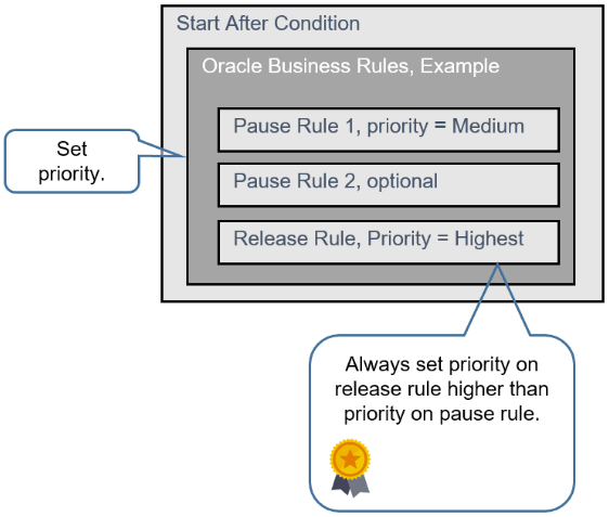

If you set up more than one rule that runs as a set of rules on the same start after condition, then you must set the release rule to the highest priority of all rules in the set.

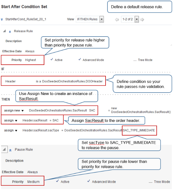

Default Release Rule
Here's an example of a release rule and a pause rule together.
guidelines when you define the release rule
Note
  • Order Management runs the rule with the highest priority first.
  • Set the Priority attribute to Highest on the rule where you use Assign New. This makes sure the rule runs first. It also makes sure that this rule creates the object that stores the result of the start-after condition (SAC). Other rules might set the value for the start-after condition.
  • If you only have one rule in your rule set, then you don't need to worry about setting priority.
  • If you don't set the priority correctly, you might encounter a null pointer error when Order Management runs the rule.
  • Don't use the If statement on the release rule to define the condition that your business logic requires. Instead, set up your conditional logic on the pause rule.
  • The rule editor requires that you set up a condition on the release rule so it passes validation, so set up a condition that's always true.
  • Use Assign New. Assign New creates a new instance of SacResult so you can assign values to it while the rules in your rule set run.

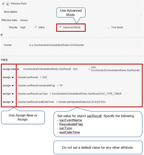

Adding a Release Rule
Note
  • Use advanced mode.
  • Specify sacResult.
    Attribute
    Description
    sacType
    Required
    sacEventName
    ReevaluateFlag
    waitDateTime
    Optional, depending on the type of pause. For example, if the rule pauses according to a dependency to resolve, then you must include sacEventName.
    For details, see Overview of Pausing Orchestration Processes.
  • Don't set default value for other attributes.

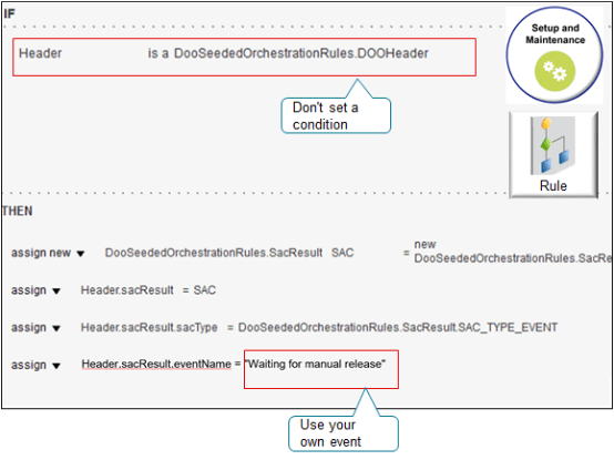

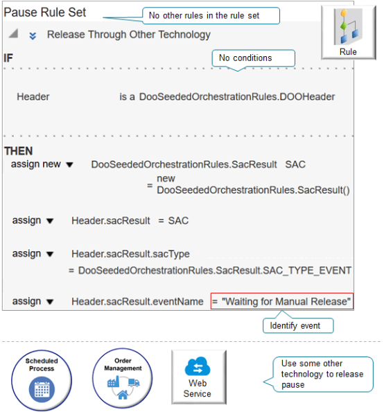

Use Some Other Technology to Release Pause
You typically use a release rule to release a pause. However, you can also use a web service, scheduled process, or the Order Management work area to release the pause.
Use Some Other Technology to Release Them
Note
  • Use only one rule in your rule set.
  • Don't specify a condition.
  • Use some other technology to release the pause task.
Here's the code.
Code
Description
Header is a DOOSeededOrchestrationRules.DOOHeader
Declare the Header variable, then store attributes of the order header that the orchestration process is currently processing into this variable.
Assign new DooSeededOrchestrationRules.SacResult SAC = new DooSeededOrchestrationRules.SacResult()
Create a new variable named SAC and set it to the SacResult type in the DooSeededOrchestrationRules method.
Assign Header.sacResult = SAC
Set the value of the sacResult object on the order header to the value that SAC contains.
Assign Header.sacResult.sacType = DooSeededOrchestrationRules.SacResult.SAC_TYPE_EVENT
Pause the orchestration process until an event happens.
Assign Header.sacResult.eventName = "Waiting for Manual Release"
Specify the event you use to identify the event that's tracking the pause. In this example, assume you named it Waiting for Manual Release.
Don't Include a Condition
If you manually release a pause or release it through a web service or scheduled process, then don't include a condition or default release rule. Here's an example where you send shippable and nonshippable lines together to invoicing, and you want to control when to send these lines.
You can specify your own eventName, such as Waiting for manual release. The Order Management work area will display this name. You can also specify it on the scheduled process that you use to release the pause.
Assign the Result
You must include these assignments as the first two actions in your Then statement:
Code Description
Set the value of sacResult on the order header to the value that SAC contains.
This code creates the object that stores the result of the start-after condition (SAC).
If you don't include these assignments, and if you don't create a release rule, then at least one of the rules in your rule set must use the Assign New action to create the SAC object.
