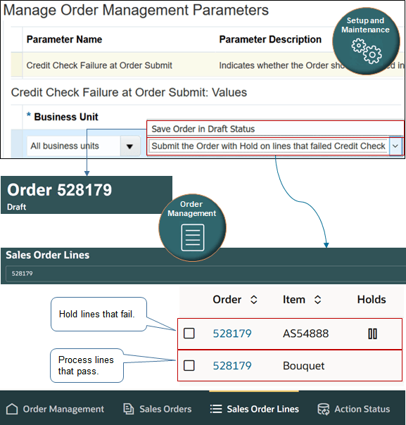

Set the Order Management Parameter
Set the value for the Credit Check Failure at Order Submit parameter.
value for parameter Credit Check Failure at Order Submit.
Note
Value
Description
Save Order in Draft Status
Save the sales order in the Draft status. Don't send any lines to order fulfillment.
Use when.
  • Your sales order includes more than one value for Bill-to Customer on the order lines, and you must move the order to fulfillment only if credit check passes for all bill-to customers.
  • You don't need to do credit check during fulfillment.
  • You don't need to release credit check hold so fulfillment can continue. You can wait for the credit analyst to resolve the hold.
Submit Order with Hold on Lines that Failed Credit Check
Save the sales order in Processing status, place a hold on each order line that fails credit check, then send order lines that aren't on hold to fulfillment.
Use when.
  • Your sales orders sometimes include more than one value for Bill-to Customer on the order lines, and you must move the order to fulfillment even if credit check fails for some or all bill-to customers.
    For example, if credit check for Bill To Customer x succeeds, and if credit check for Bill To Customer y fails, then Order Management can send order lines for customer x to order fulfillment, and place order lines for customer y on hold.
    If order lines include only one Bill To Customer value, then Order Management uses the order total when it checks credit.
  • You don't revise attributes that affect credit check, or you might cancel the failed lines.
  • You must release credit check hold so fulfillment can continue, even if you must manually release the hold.
