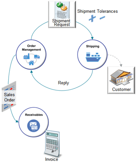

How it Works
Oracle Order Management creates and sends a shipment request to Oracle Shipping. The request includes shipment tolerances.
Shipping enforces the tolerances, ships the line, then sends a reply to Order Management.
Order Management evaluates the order line to determine whether to proceed to the next orchestration process step, or to split the line.
Order Management sends the sales order to Receivables.
Receivables invoices the transaction.

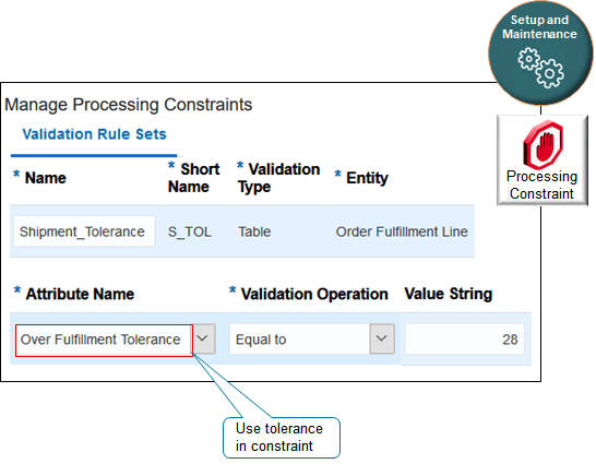

Constraints
Use tolerances in a processing constraint or order management extension to create a condition and specify more detailed behavior than what you can set with Order Management parameters or in Product Information Management.
For example:
If the Over Fulfllment Tolerance
attribute on the order line is equal to 28, then prevent the
user from modifying the line.
