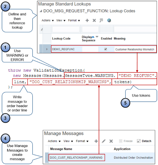

Set Up Your Message
code that Defines Messages
Note
  1. messageType. Define the messageType as WARNING or ERROR. The Order Management work area uses a different icon for each type.
  2. Lookup. Use the Manage Order Lookups page in the Setup and Maintenance work area to categorize your messages, then reference them from your code.
    Use predefined lookups or create your own. Categorizing helps the Order Entry Specialist search for messages and view them in analytic charts.
    Use Error to improve search and display because errors display in work area Order Management in attribute Error Type.
    In this example, assume you define the Meaning as Customer Relationship Mismatch.
  3. Header or line. Indicate where the error happens. Use one of these values.
    • header. Apply the message to an error that happens on the order header.
    • line. Apply the message to an error that happens on an order line.
      The example in the screen print uses line. This example includes code (not visible, for brevity) above throw new ValidationException that defines line as a variable, uses it to iterate through all the lines in the sales order, then saves the order line number where the error happens, such as line 3. At run time, Order Management displays an icon on line 3 that the Order Entry Specialist can click to examine message details.
  4. Manage Messages. Use the Manage Messages page in the Setup and Maintenance work area.
    • Referencing a message provides advantages over hard coding the message.
    • Reference the message from different extensions, manage the message independently of the extension, and translate the message to some other language besides English.
    • Using the Manage Messages page can simplify message management because other developers and administrators can then use Manage Messages instead of modifying hard coded messages in your extension, which requires knowledge of writing in Groovy.
    • You can also define a message to help you troubleshoot your extension during development. You can include details in the message that display the state of various objects to help you pinpoint problem areas. Remove the message when you're ready to deploy your extension to your production environment.
  5. Use tokens as placeholders for variable content.

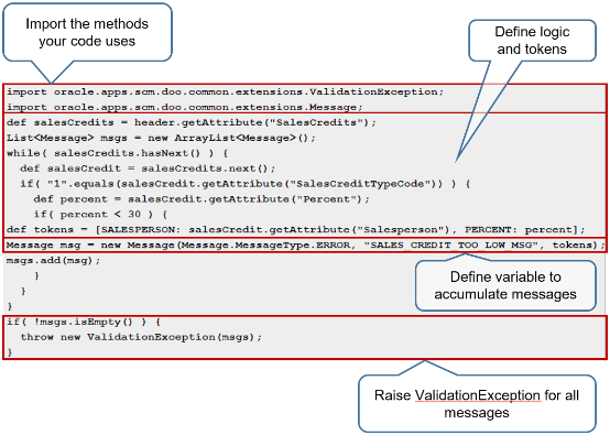

code that accumulates messages
If the revenue percentage is less than 30% for the sales credit, then the extension creates a message and stores it in a local list. The extension processes all sales credits. If the local list contains any messages after it finishes processing sales credits, then the extension displays them in a dialog in the Order Management work area.
Here is the code that this example uses to examine each sales credit.

Here's the complete code without comments.
import oracle.apps.scm.doo.common.extensions.ValidationException;
import oracle.apps.scm.doo.common.extensions.Message;
def salesCredits = header.getAttribute("SalesCredits");
List<Message> msgs = new ArrayList<Message>();
while( salesCredits.hasNext() ) {
 def salesCredit = salesCredits.next();
  if( "1".equals(salesCredit.getAttribute("SalesCreditTypeCode")) ) {
   def percent = salesCredit.getAttribute("Percent");
    if ( percent < 30 ) {
def tokens = [SALESPERSON: salesCredit.getAttribute("Salesperson"), PERCENT: percent];
Message msg = new Message(Message.MessageType.ERROR, "SALES_CREDIT_TOO_LOW_MSG", tokens);
msgs.add(msg);
if( !msgs.isEmpty() ) {
 throw new ValidationException(msgs);

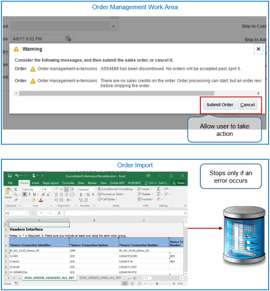

Consider Order Import Behavior
Import behavior it different depending on whether your extension creates a warning message or error message.
behavior differences depending on whether your extension creates a warning message or error message
Note
  • Sales orders entered in the Order Management work area. The Warning dialog in work area Order Management allows the Order Entry Specialist to examine the warning, then submit the sales order or cancel.
  • Source orders imported from a source system. Order processing stops only if an error happens. If only warnings happen, then you can view the messages but the import submits the sales order to order fulfillment. It doesn't allow user intervention.
