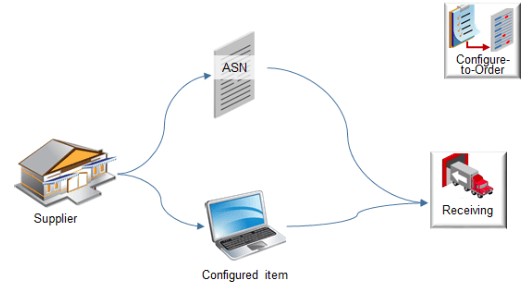

A configured item meets the needs of a specific sales order. So the make flow picks and moves it directly to a shipping lane from receiving instead of putting it into stock. The receiving agent can view the sales order.
The flow receives the configured item into inventory, picks, then ships it just like it does any other item in inventory. The configured item doesn't need a unique process or special treatment to transact it in your shipping application.
The flow also supports an advanced shipment notice (ASN) that it receives from your supplier or during a transfer order from a shipping organization.

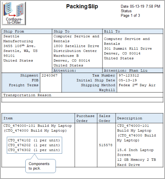

Examine the Print Packing Slip Report.
Click Print Packing Slip Report.
The Packing Slip Report displays the details of the configured item.

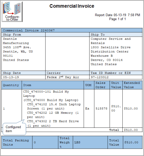

Examine the invoice.
The invoice includes.
The configured item, CTO_474000-101 Build My Laptop
The model, CTO_474000 Build My Laptop
Each option your user chose, such as CTO_474102 15.6 Inch Laptop Screen (1 per unit)
Note
It isn't necessary to do any more set up to get and display the invoice.
A web service in Supply Chain Orchestration gets details for this sales view when you ship confirm the sales order.
You can view the model and options for the configured item on the commercial invoice and the packing slip.
The invoice displays the quantity for each component in the configured item assuming that the configured item quantity is one.
You don't have to do any special document setup for configured items.
Here's an example of the packing slip.
