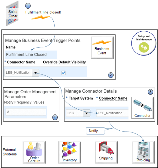

Here's how it works.
Note
Order Management monitors conditions that happen during order fulfillment according to the trigger points that you specify.
For example, if you enable the Notify External System option for the Shipped status value on a status rule set, then Order Management communicates the business event each time it sets an order line status to Shipped, and it sends the business event to the endpoint URL of the connector that you set up for the Fulfillment Line Status Update business event. For details, see Add Status Conditions to Order Lines.
You use the Manage Business Event Trigger Points page in the Setup and Maintenance work area to specify the trigger point. If Order Management determines a trigger point happened, then it uses the Connector Name attribute on the Manage Business Event Trigger Points page to identify the connector it will use to communicate with the system.
The connector communicates with the system. You use the connector to specify the URL that locates the system and the security credentials that your system needs to communicate data. For example, the order line status is Shipped, so you notify your invoicing system that the order is ready to invoice.
As an option, you can use the Notify Frequency parameter to specify how frequently Order Management sends notifications. For details, see Manage Order Management Parameters.
A business event trigger point is the condition that causes a business event to happen.
You must associate a connector with the business event that you specify. For details, see Send Notifications from Order Management to Other Systems.
The business events that this page displays aren't active, by default, except for business events that monitor closing an order line.
A modification that you make on this page takes effect immediately.
The settings that you make affect only one instance of Order Management.
You can't add or delete the business events that this page displays.
Set up only the business event trigger points that you need. Each trigger point might affect performance.
