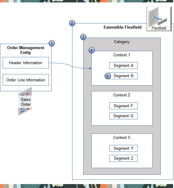

Use a hierarchy to specify how you want to display an extensible flexfield in the Order Management work area.
Here's the hierarchy:
Note
Order Management Entity. The top-level object in the hierarchy. You can specify one of these entities:
Header Information. Store details about the order header.
Order Line Information. Store details about the order line while Order Management processes the order line.
Extensible Flexfield. Each flexfield includes categories, contexts, and segments.
Extensible Flexfield Category. Organize your data into a category according to attributes that contain similar business data. Specify where to display the flexfield in the Order Management work area, such as on the order header. You can use only one category for each entity.
Extensible Flexfield Context. Specify how to display the attribute. For example:
Specify criteria that determines the attribute to display.
Type of interface element that will display the attribute, such as text box or list of values.
Whether the Order Entry Specialist can view or edit the attribute.
Validation to do on the attribute.
Help text to display for the attribute.
Data type of the attribute.
Table column that stores the attribute.
You can specify one or more contexts in each category.
Extensible Flexfield Segment. Specify the attributes. The segment is equivalent to a sales order's attribute. Each context includes one or more segments that you can use to specify the order's attributes that store your data. You can specify one or more segments in each context.
Consider an example:
Note
Context1 stores details about trade compliance.
SegmentA references an attribute that stores the compliance description.
SegmentB references an attribute that stores the compliance date.
Context2 stores details about the call center representative who manages details about trade compliance.
SegmentF references an attribute that stores the representative name.
SegmentG references an attribute that stores the name of the person who manages the representative.

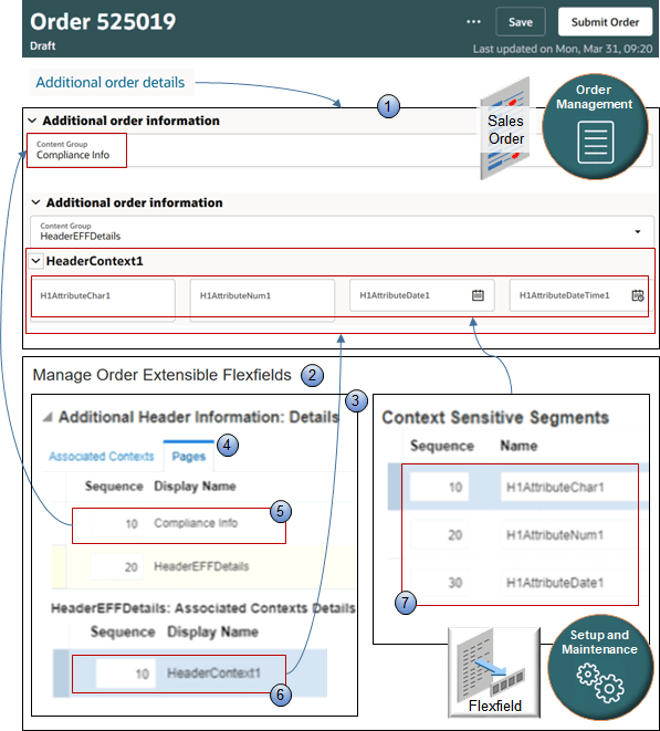

This example displays an extensible flexfield in the Order Management work area:
Note
Additional Order Information. Part of a dialog that displays when you click Additional Order Details on the order header in the Order Management work area.
Manage Order Extensible Flexfields. The page that you use in the Setup and Maintenance work area to set up your flexfield.
Additional Header Information. Specify the data to display and how to display it.
Pages tab. Specify each area where you want to display your flexfield. In this example, the Pages tab specifies one area named Compliance Info and another area named HeaderEFFDetails. The example displays HeaderEFFDetails in the dialog. You can specify one or more areas, and you can specify one more contexts in each area.
In this example, the Pages tab specifies HeaderContext1 and HeaderContext2. However, for brevity, the screen capture displays only HeaderContext1. The Sequence specifies the sequence to use when displaying these contexts, with 1 at the top, 2 below 1, 3 below 2, and so on.
Sequence and Display Name for page. Specify the name of each category to display in the dialog. Sequence specifies the sequence to display the pages in the dialog. In the example, the Sequence is 10 for Compliance Info and 20 for HeaderEFFDetails, so the dialog displays Compliance Info first, then HeaderEFFDetails.
Sequence and Display Name for context. Specify the name of each context to display in the dialog. For example, HeaderContext1 organizes similar business data into a concise section of the dialog.
Context Sensitive Segment. Specify one or more segments to display details for each attribute. The Sequence specifies the sequence to use when displaying segments in the section. You can specify these segments in each context:
20 character segments. You can use up to 150 characters for each character segment.
10 number segments.
Five date segments.
Five date and time segments.
