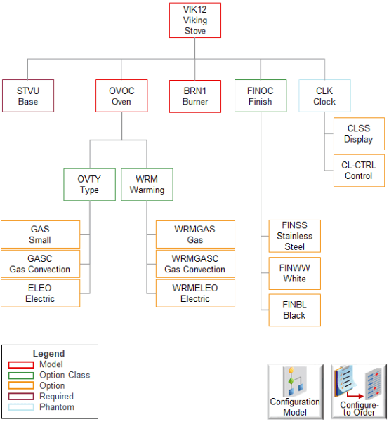

Here's an example of an assemble-to-order model for the VIK12 Stove.
Get an introduction to this model. For details, see Examples of Using Configure-to-Order.
The top parent, VIK12 Stove, includes:
  • STVU, which is the stove unit base.
  • OVOC, an assemble-to-order model for the oven.
  • BRN1, an assemble-to-order model for the burners.
  • FINOC, an option class for the finish. It contains options your user can choose to specify the type of finish, such as stainless steel.
  • CLK, a phantom for the clock assembly. It includes options your user can choose to specify the display and type of control. A phantom is an item that you physically build but don't stock. In this example, you assemble the clock on demand. You don't build it in anticipation of demand and stock it.
OVOC, the oven, contains option classes.
  • Option class OVTY specifies the oven type. It contains options Gas, Gas Convection, and Electric. Gas Convection and Electric aren't configure options.
  • Option class WRM specifies options for the warming oven.

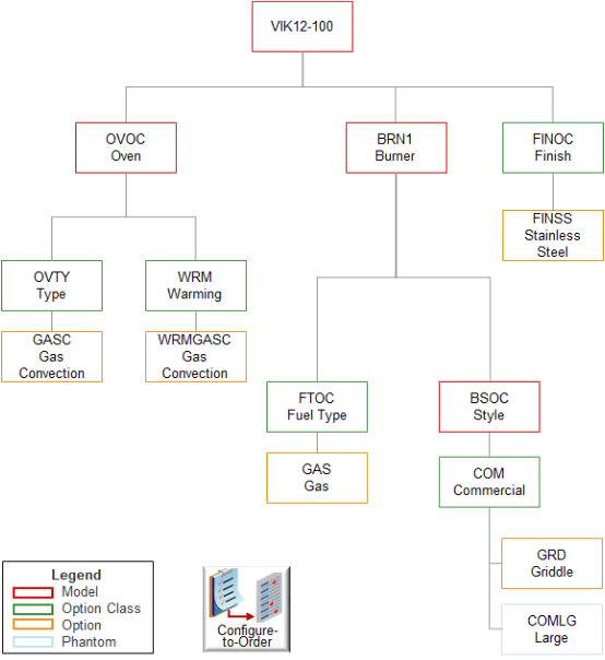

Here's an example configured item, VIK12-100, that your customer ordered. It includes only the options the customer chose.
Note
  • STVU is the stove unit base. Its required. The work order includes STVU but VIK12-100 doesn't.
  • An oven can use only one type of fuel, burner style, oven type, and warming oven. So each of these components includes only the one option you customer chooses.
  • The customer didn't want the clock, didn't choose CLK, so its not in VIK12-100.
  • The customer chose COM, the commercial burner, and GRD, the griddle for the commercial burner. The customer also chose COMLG, the large commercial burner.
