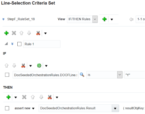

Here's the rule you will create.
line selection rule
where
  • DooSeededOrchestrationRules is a dictionary that contains a set of predefined functions, variables, objects, and other data you can use to define behavior for an orchestration process.
  • DOOFLine contains order line attributes, such as orderedQty, customerPONumber, creationDate, and so on. You can reference these attributes and use their values in your rule.
  • shippableFlag is an order line attribute.
  • Y is one possible value of shippableFlag.
This example includes a business rule that requires you to use a dictionary, fact, and other objects. We strongly recommend that you familiarize yourself with these objects before you proceed. For details, see the Business Rules chapter in the Implementing Order Management book.

  5. In the Line Selection Criteria dialog, click Add Rule > Expand.
  6. In the If area, click Left Value, expand DOOSeededOrchestrationRules > DOOFline, click ShippableFlag, then click OK.
  7. In the Right Value attribute, enter "Y". You must include the double quotation marks.

Create the Then statement.
  1. In the Then area, click Add Action > Assert New.
  2. Click Select a Target > DooSeededOrchestrationRules.Result.
  3. Click Edit Properties.
  4. In the Properties dialog, in the ResultObjKey row, click Value.
  5. In the Condition Browser, enter DOOFLine, wait a moment, expand DooSeededOrchestrationRules.DOOFLine, click FulfillLineId, then click OK > OK.
  6. In the Line Selection Criteria dialog, click Validate, make sure the Validation Log that displays doesn't contain errors, then click Save.
