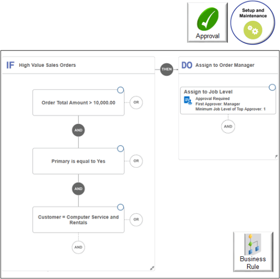

Assume you must need to create this routing rule:
If the order total is greater than $10,000, and if the Primary is yes, and if the customer is Computer Service and Rentals, then request and get approval from a manager.
Here's the rule that you will create.
Summary of the Set Up
Create the approval rule and the IF.
Create the first AND.
Create the second AND.
Create the DO.
Activate and publish your rule.
Test your set up.

Create the Approval Rule and the IF
Make sure you have the privileges that you need to administer Order Management.
Set the Start Approval Process for Sales Orders parameter to Yes for all source systems.
For details, see Manage Order Management Parameters.
Go to the Setup and Maintenance work area, then go to the task:
Offering: Order Management
Functional Area: Orders
Task: Manage Order Approval Rules
On the Manage Order Approval Rules page, click Create New Rule.
Change the rule name.
Current Name
New Name
New Rule
Get Approval for High Value Sales Orders
Name the If statement so it reflects the meaning of the condition.
Click Enter Description.
In the Enter Description dialog, enter
High Value Sales Orders, then click OK.
Click New Condition (the dashed circle in the IF area).
In the Create Condition dialog, enter
order total, wait a moment, then click Order Total Amount (Order Header > Order Totals).Notice that the dialog displays suggestions when you wait a moment after you finish typing.
In the Create Condition dialog, set the values, then click OK.
Field
Value
Attribute
Order Total Amount
Condition
greater than ( > )
Value
10000
Notice that the IF area now displays the condition.
Order Total Amount > 10,000
Click Save.
Create the First AND
Click AND.
primary, wait a moment, then click Primary (Order Header > Order Totals). -
Field
Value
Attribute
Primary
Condition
Is equal to
Value
Yes
Primary is equal to Yes
Click Save.
Create the Second AND
Below
Primary is equal to Yes, click AND. -
customer, wait a moment, then click Customer (Order Header). -
In the Create Condition dialog, set the values.
Field
Value
Attribute
Customer
Condition
Equals ( =)
Click Search.
In the Search dialog, in the Name attribute, enter
Computer Service and Rentals, then click Search. -
In the search results, click Computer Service and Rentals, then click OK.
In the Create Condition dialog, click OK.
Customer = Computer Service and Rentals
Click Save.
Create the DO
Click THEN > DO.
Name the DO so it reflects the meaning of the action.
Assign to Order Manager, then click OK.
Click New Action (the dashed circle in the DO area), then click Perform an Action.
In the Create Action dialog, set the action to
Assign to Job Level. -
In the Create Action dialog, verify the values.
Field
Value
Action
Assign to Job Level
Required Action
Approval Required
Approval Chain Based On
Task Creator
First Approver
Manager
Minimum Job Level of Top Approver
1
Utilized Approvers
All Levels
Click Search.
In the Search dialog, next to Users, enter
manager, then click Search. -
In the Search for Highest Possible Approver dialog, in the manager row, click the radio button, then click OK.
Verify that Highest Possible Approver contains
manager, then click OK.Notice that the DO area now displays the condition.
Assign to Job Level
Click Save and Close.

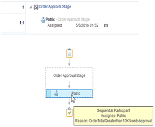

Verify that Order Management updates the order status to Approval Pending.
Click View Approval Information, then verify the approval details reflect the approval rule you created.
In a separate browser session, Make sure you have the privileges that you need to manage sales orders.
Open the Pending Notifications page, locate the link for the approval request, such as Action Required: Approval Request for Order 258093, then click Approve.
Navigate to the browser session for the Order Entry Specialist, refresh the page, then verify that the order status is now Processing.
