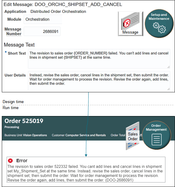

Examine a Predefined Message
  1. Go to the Order Management work area and create a sales order.
  2. Add two order lines, assign each line to a shipment set named My_Shipment_Set, then click Submit.
  3. Click Create Revision.
  4. Add a new order line and assign it to My_Shipment_Set.
  5. To cancel line 2, set the quantity on line 2 to zero.
  6. Click Submit, then examine the message that displays.
    In this example, you creates a sales order, adds two order lines, and assigns each line to My_Shipment_Set.
    Note
    • Order Management doesn't allow you to add a new line and cancel a line in the same shipment set during the same revision, so it displays the error message.
    • The predefined DOO_ORCHC_SHIPSET_ADD_CANCEL message defines the message text.

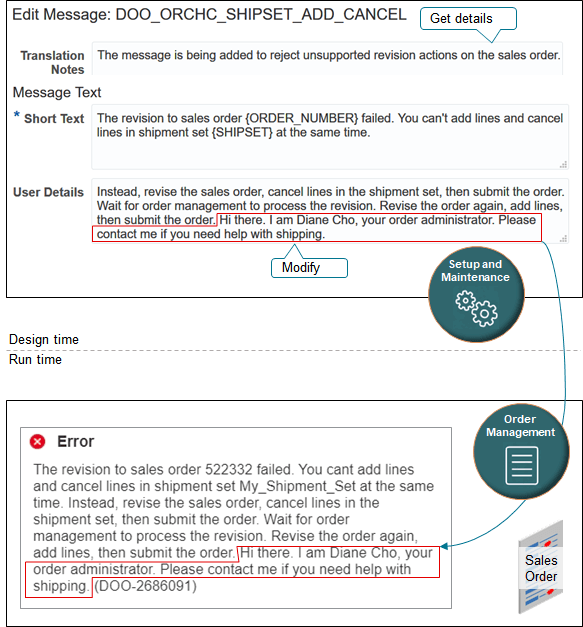

Modify a Predefined Message
Assume you want to add some text to DOO_ORCHC_SHIPSET_ADD_CANCEL.
Try it.

    • Search Message Name for DOO_ORCHC_SHIPSET_ADD_CANCEL.
  2. Edit the message.
    • In the search results, click the line that includes DOO_ORCHC_SHIPSET_ADD_CANCEL in the Message Name column, then click Actions > Edit.
    • On the Edit Message page, add your text at the end of the User Details attribute. For example:
      Instead, revise the sales order, cancel lines in the shipment set, then submit the order. Wait for Order Management to process the revision. Revise the order again, add lines, then submit the order. Hi there. I am Diane Cho, your order administrator. Please contact me if you need help with shipping.
      Note
      • Don't modify the Message Number. Order Management uses it to uniquely identify the message.
      • Examine the Translation Notes. They might contain details that describe when and why a message displays. Use them to help troubleshoot errors or warnings.
      • In general, don't modify predefined text in the Short Text attribute. Each message describes an error or warning condition. Its important to keep the predefined Short Text to support these conditions.
      • Short Text has a 160 character limit.
      • In general, don't modify predefined text in the User Details attribute. If you want to add text, add it immediately after the predefined text.
    • Click Save.
  3. Test your set up.
    • Go to the Order Management work area in your other browser.
    • If the work area still displays the error message, then close the message dialog.
    • Click Submit.
    • Verify that the message displays the text you added.
