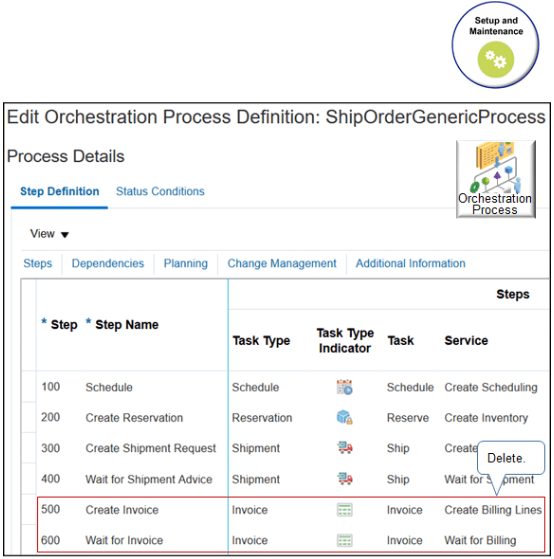

    • On the Manage Orchestration Process Definitions page, search for ShipOrderGenericProcess, then click Actions > Edit.
    • On the Edit Orchestration Process Definitions page, click Actions > Revise Process.
    • In the Process Details area, delete the Create Invoice step and the Wait for Invoice step.
      Page Edit Orchestration Process Definitions
    • Deploy your orchestration process, then click Save and Close.
    • On the Manage Orchestration Process Definitions page, click Cancel.
