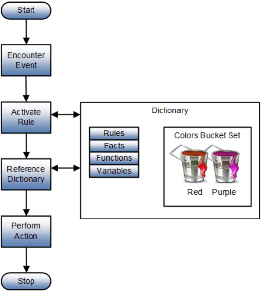

Assume you create a Colors bucket set that includes
string values of red and purple. You can write a rule for each color.
You can also write one rule for blue and another rule for purple.

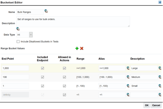

Here's an example bucket set that groups ranges of values into a large, a medium, or a small bucket.
