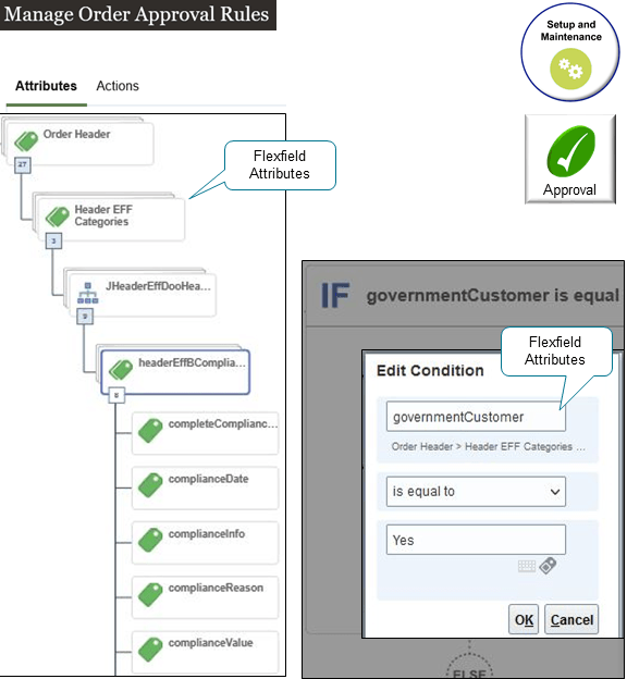

- Create a new approval rule or modify an existing one.
Assume you're adding a flexfield on the order header.
- Go to the Setup and Maintenance work area, then open the Manage Order Approval Rules task.
- On the Manage Order Approval Rules page, click Create New Rule.
- In the Attributes area, click Order Header > Header EFF
Categories.
Notice that the Header EFF Categories tree contains the categories that you created in step 1.
- Click New Condition.
- In the Create Condition dialog, enter
Header. - Click HeaderId (Order Header > Header EFF Categories).
- Notice how the dialog contains the categories that you created in step 1.
