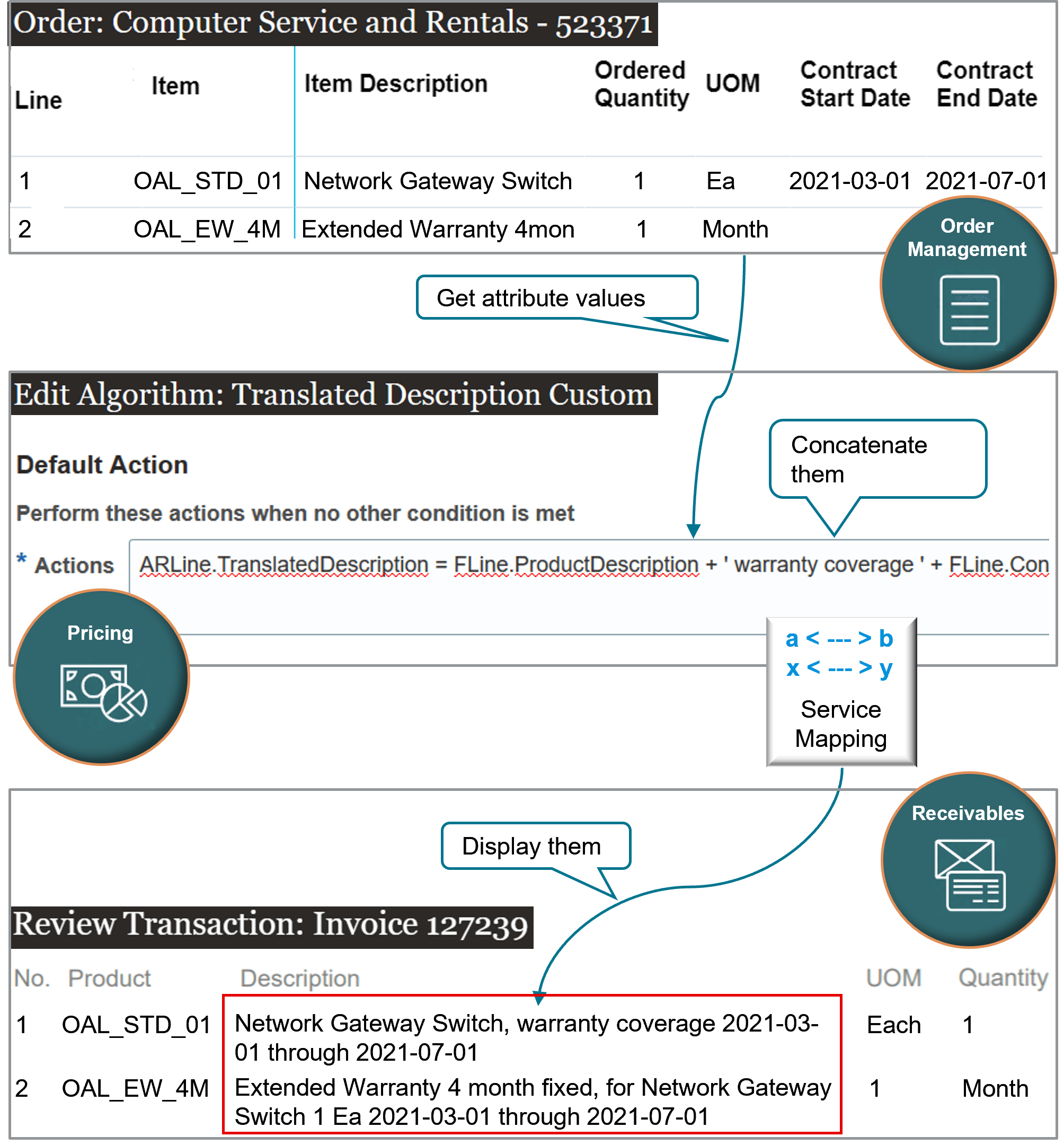

Use Integration Algorithms to Implement Complex Logic
Use an integration algorithm to implement specialized behavior when you integrate Order Management.
Here's an example.
Note
You get attributes value on the order line from Order Management, including the Item Description, Quantity, Unit of Measure, Contract Start Date, and Contract End Date.
You use an integration algorithm in the Pricing Administration work area to concatenate the values for the attributes into a single string of text, and then use a service mapping to map it to Oracle Receivables.
The Description on the invoice in Oracle Receivables displays the string.

For a multimedia demonstration of a similar set up, go to Order Management Enhancements. The demonstration starts at 49:35 and ends at 59:03.

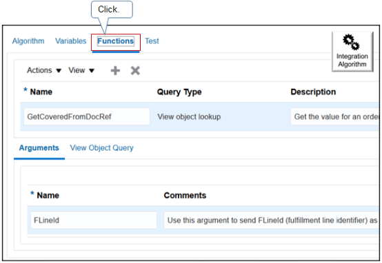

Add Functions to Your Integration Algorithm
Try it.
Add a function.
Click Functions, click Actions > Add Row, then set the values.
Attribute
Value
Name
GetCoveredFromDocRef
Query Type
View Object Lookup
Description
Get the value that identifies the order line that has the covered item.
In the Arguments area, click Add Row, then add an argument.
Attribute
Value
Name
FLineId
Comments
Use this argument to send the FLineId (order line identifier) that identifies the order line that contains the coverage item, and then return a value that identifies the covered item.

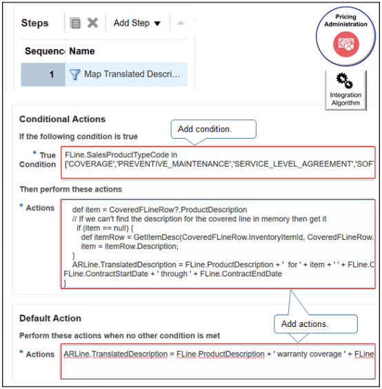

Add a Step to Your Integration Algorithm
Add a conditional step that runs differently depending on whether the order line that the algorithm is currently processing contains a covered item or a coverage item.
Try it.
Click the Algorithm tab, click Add Step > Conditional Action, then set the values.

In the Execute Condition area, click Add Condition > Default Action.
You will add the code that creates the concatenated string for the covered item.
In the Default Action area, add code in the Actions window.
ARLine.TranslatedDescription = FLine.ProductDescription + ' warranty coverage ' + FLine.ContractStartDate + ' through ' + FLine.ContractEndDate
where
Code
What it Does
Create a variable named TranslatedDescription and add it to the ARLine data set.
Store the value of the concatenated string in the TranslatedDescription variable.
Get the value of the description for the order line that we're currently processing. This is the description for the covered item from the FLine data set.
Get the value of the contract start date for the covered item from the FLine data set.
If you add coverage to a covered item, then you use the Contract Start Date and Contract End Date on the covered item, not the coverage item. The coverage item provides coverage for a duration, such as 1 Year, but not for the specific start date and end date. Instead, you set the start date and end date on the covered item. This way, you can use the coverage item for a variety of covered items.
Get the value of the contract end date for the covered item from the FLine data set.
Concatenate the value of one string to another. Insert a space between these concatenated strings.
+ ' through ' +
Concatenate the value of one string to another. Insert text between these concatenated strings. For example, insert the phrase
warranty coverage
between these concatenated strings.This action applies to order lines that contain a standard item or shippable item.
This code specifies how to concatenate the attribute values. Here's an example of the run time value that this code renders.
Network Gateway Switch, warranty coverage 2021-03-01 through 2021-07-01
Add the code that creates the concatenated string for the coverage item.
You will add a new conditional action that applies only if the item is a coverage item. The concatenation is slightly different for a coverage item than it is for a covered item. You also need to get some details from the line that has the covered item.
In the Execute Condition area, click Add Condition > True Condition.
In the Conditional Actions area, add code in the True Condition window.
FLine.SalesProductTypeCode in ['COVERAGE','PREVENTIVE_MAINTENANCE','SERVICE_LEVEL_AGREEMENT','SOFTWARE_MAINTENANCE','INCLUDED_WARRANTY']
The SalesProductTypeCode attribute on the order line specifies whether the line contains a coverage item, such as a maintenance agreement, warranty, and so on. So this code specifies to do this conditional action only if the line contains a coverage item.
Add code in the Actions window.
CoveredFlineDocRefRow = GetCoveredFromDocRef(FLine.FulfillLineId) if (CoveredFlineDocRefRow?.DocSublineId != null) { // Locate the covered line according to DocSublineId CoveredFLineRow = AllFLines.locate([FulfillLineId: Long.parseLong(CoveredFlineDocRefRow?.DocSublineId)]) // If we can't find the covered line in memory then get it if (CoveredFLineRow == null) CoveredFLineRow = GetCoveredFLine(CoveredFlineDocRefRow?.DocSublineId) def item = CoveredFLineRow?.ProductDescription // If we can't find the description for the covered line in memory then get it if (item == null) { def itemRow = GetItemDesc(CoveredFLineRow.InventoryItemId, CoveredFLineRow.InventoryOrganizationId) item = itemRow.Description; } ARLine.TranslatedDescription = FLine.ProductDescription + ' for ' + item + ' ' + FLine.OrderedQty.toString() + ' ' + FLine.OrderedUom + ' ' + FLine.ContractStartDate + ' through ' + FLine.ContractEndDate }

Set attributes on the service so it calls your algorithm.
Click Services.
Click the row that contains InvoiceService in the Service column.
Set the values.
Implementation Type
Implementation
Algorithm
Translated Description Custom
This is the name of the integration algorithm that you created earlier in this procedure.

Test Your Setup
Create a sales order.
Go to the Order Management work area, create a sales order, then add two order lines.
Item
Quantity
OAL_STD_01 Network Gateway Switch
1
OAL_EW_4M_Fixed Extended Warranty
1
Click Submit
Notice the sales order number. For this example, assume its 529986.
Verify that Order Management correctly sends your data to Oracle Receivables.
Make sure you have the privileges that you need to manage Oracle Receivables. For details, see Get the Privileges That You Need to Implement Order Management.
Go to the Billing work area, then click Tasks > Manage Transactions.
For details, see Requirements for Completing a Receivables Transaction.
On the Manage Transactions page, search for the transaction.
Attribute
Value
Business Unit
Vision Operations
Transaction Source
Distributed Order Orchestration
Reference
529986
On the Review Transaction page, click View Image.
On the printed invoice that displays, verify the description for the invoice line that has the network switch.
Attribute
Value
Description
Notice that this value is a concatenation of the description of the covered item, and then the start date and end date of the coverage. It is the result of the Default action that you created in the algorithm.
Verify the description for the invoice line that has the extended warranty.
Attribute
Value
Description
Extended Warranty 4 month fixed, for Network Gateway Switch 1 Ea 2021-03-01 through 2021-07-01
Notice that this value is a concatenation of the description of the coverage item, and then the description of the covered item, and then the quantity, unit of measure, start date, and end date of the coverage item.
This line contains a coverage item, so it meets the condition from the algorithm. It is the result of the Conditional action that you created in the algorithm.
