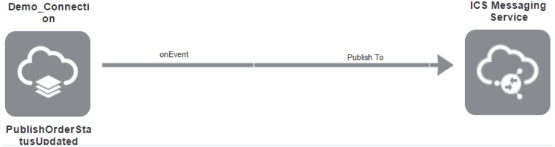

Create an Integration
Here's the integration you create.
integration that monitors business events.
Create an integration that monitors business events.

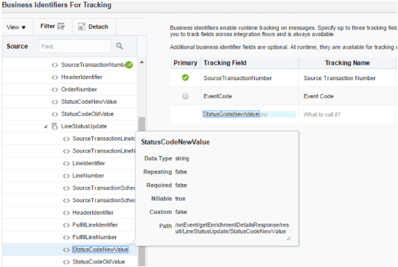

Track Business Events
Track business events so you can test and monitor your integration. Track at least one business event so you can monitor your deployment during normal operations.
  1. On the page that displays, click Tracking.
    Use Tracking to test your set up. You can view the business events that your integration uses in Integration Cloud Service's monitoring system.
  2. For this example, on the Business Identifiers for Tracking page, in the Source tree, under the result branch, click Load More.
    Here are the business identifiers you will track.
    business identifiers you select to track.
  3. Drag and drop SourceTransactionNumber from the hierarchy tree to the first row of the Tracking Field column.
  4. Drag and drop Event from the hierarchy tree to the second row of the Tracking Field column.
  5. In the result branch, expand LineStatusUpdate, then click Load More.
  6. Drag and drop StatusCodeNewValue from the hierarchy tree to the third row of the Tracking Field column.
  7. Click Done.

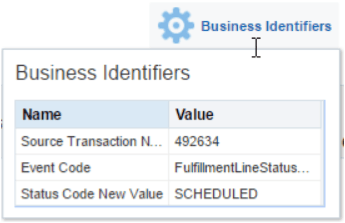

  6. In the search results, notice that Order Management used more than one event for the sales order. Click the event at the top of the list, which is the most recent event.
  7. On the page that displays, click Business Identifiers, then verify that the tracking details you set up for tracking earlier displays.
    Here are the details you set up in this example.
    • SourceTransactionNumber. Identifies the order number.
    • Event. Identifies the business event that gets triggered, which is FulfillmentLineStatusUpdate.
    • StatusCodeNewValue. Identifies the new status value of the order line, which is Scheduled.
