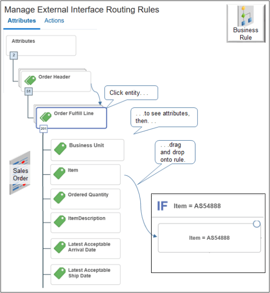

Use the Tree in Visual Information Builder
Use the tree in Visual Information Builder to find the attributes that you can use in your rule, then add them.
The tree displays the hierarchy of the objects that you can add to the rule. For example, the Manage External Interface Routing Rules page displays the hierarchy of attributes that you can add.
A sales order is an object in Order Management.
A sales order includes entities, such as.
Order Header
Order Fulfill Line
Each entity includes attributes. For example, here are some attributes in the Order Fulfill Line entity.
Business Unit
Item
Ordered Quantity
And many others
To add an attribute to your rule, click the attribute, drag, then drop it onto the rule.
For example, drag the Item attribute onto the If statement of your rule.
You can use the tree to set up a wide range of conditional logic that meets your business requirements. If you prefer not to use the tree, you can search directly in the If statement or Then statement for the entity, attribute, values, and so on.

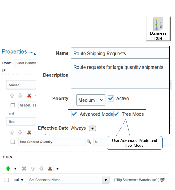

Use Advanced Mode and Tree Mode in Oracle Business Rules
Use Advanced Mode and Tree Mode to help simplify creating and managing your rule. These modes help structure your rule to make sure it contains the correct logic structure, and to filter the choices that are available to you to help make sure the rule references objects correctly according to structure.

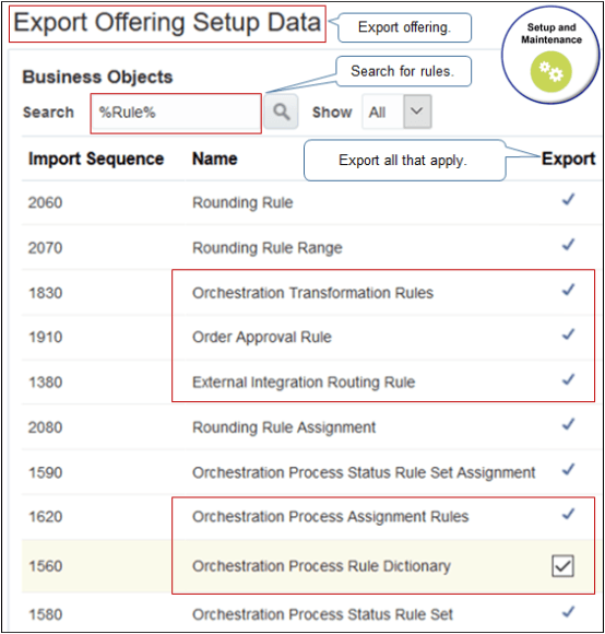

Migrate Between Environments
Specify types of rules to migrate.
Note
In the Setup and Maintenance work area, click Actions > Export > Create New Export.
Export the business objects that you need to run your business rule. For example:
Approval Rules
Routing Rules
Assignment Rules
Orchestration Process Rule Dictionary
For details, see.
Export Offering Setup
