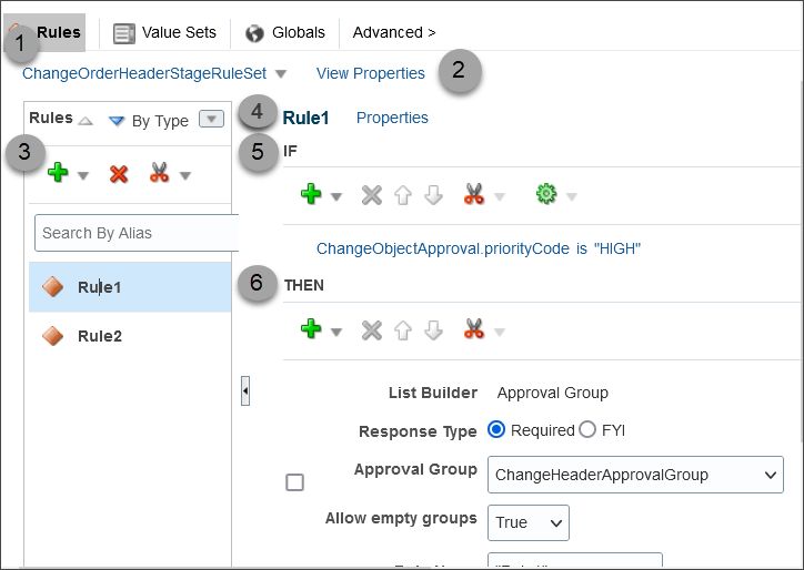

Click the View Properties link that's beside the rule set name to see the Effective Date setting and the Active checkbox. The rule set needs to be effective and active to apply when people create workflow tasks. It's a good idea to leave the effective date set to Always.
Here's a screenshot to help you understand what you see in the Rules subtab on the Assignees tab:
Callout Number |
What It Is |
1 |
The rule set drop-down list. Note that only ChangeOrderHeaderStageRuleSet is supported for change orders. |
2 |
The Properties link to open properties for the rule set. Use the link that appears next to the rule name. |
3 |
The Rules pane that lists the rules within the rule set. Includes a toolbar for adding or deleting rules. For example to add or delete rule. |
4 |
The name of the rule that’s selected in the Rules pane. Can be modified by clicking the Properties link that's next to the rule. |
| 5 | The If section of the rule, where the conditions are defined and there’s a toolbar for working on those conditions. |
| 6 | The Then section of the rule, which defines what happens when the conditions are met. There’s also a toolbar specific to this section. |

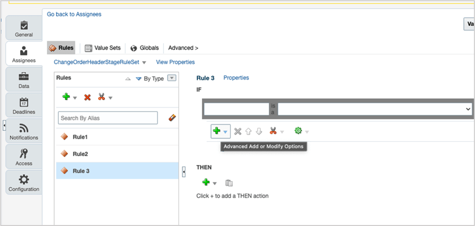

In the If section of the rule, define conditions for the rule. Each line in this section is called a test.
- For existing conditions, select the rule that you want to edit. To add a new
rule, click the Advanced Add or Modify Options icon and
select simple test.
Click the Left Value icon to select an attribute in the Condition Browser dialog box. Click OK. For example, ChangeObjectApproval.priorityCode.
Select an operator. For example: is.
Click the Right Value icon to select something from the Condition Browser dialog box, or enter a value in the corresponding field. Click OK. For example, "HIGH".

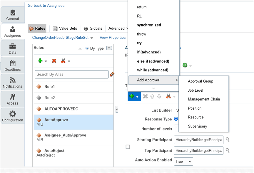

In the Then section of the rule, define what happens when the conditions in the If section are met.
Here's how you configure the LeaderGroup as approver using the Approval Group list builder.
- Click Insert Action(plus) icon > Add
Approver > Approval Group.
The table shows the values you must enter in the Then statement when you want the change assignee from LeaderGroup for the task.
Field Value List Builder Approval Group Response Type Required Approval Group LeaderGroup (predefined in Approval Groups) Allow Empty Groups False Rule Name HighPriorityLeaderApproval Here's an image that shows how you add an approver.
