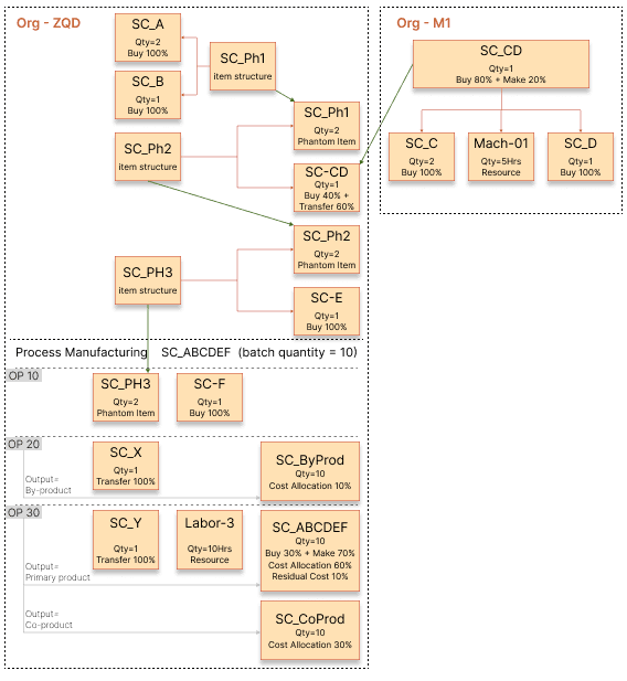

Scenario
Organization ZQD is manufacturing the item SC_ABCDEF. Here's the overall output of the process manufacturing.
Item | Sourcing Rule | Output | Source Allocation Percentage | Quantity | Cost Allocation in Work Definition |
SC_ABCDEF | Make | Primary product | 70% | 10 | 60% |
SC_ABCDEF | Buy | Primary product | 30% | 10 | N/A |
SC_CoProd | Make | Co-product | 100% | 10 | 30% |
SC_ByProd | Make | By-product | 100% | 10 | 10% |
To manufacture the item SC_ABCDEF, you need various other items. The items, their sourcing rules, and quantities are listed in this table:
Item | Organization | Sourcing Rule | Source Organization | Source Allocation Percentage | Quantity |
SC_ABCDEF | ZQD | Make | N/A | 70% | 10 |
SC_ABCDEF | ZQD | Buy | N/A | 30% | 10 |
SC_Y | ZQD | Transfer | M1 | 100% | 1 |
SC_X | ZQD | Transfer | M1 | 100% | 1 |
SC_F | ZQD | Buy | N/A | 100% | 1 |
SC_PH3 | ZQD | N/A | N/A | 100% | 2 |
SC_E | ZQD | Buy | N/A | 100% | 2 |
SC_Ph2 | ZQD | N/A | N/A | 100% | 4 |
SC_CD | ZQD | Buy | N/A | 40% | 4 |
SC_CD | ZQD | Transfer | M1 | 60% | 4 |
SC_Ph1 | ZQD | N/A | N/A | 100% | 8 |
SC_A | ZQD | Buy | N/A | 100% | 16 |
SC_B | ZQD | Buy | N/A | 100% | 8 |
In the above table, you will note that no sourcing rules are mentioned for the phantom items SC_Ph1, SC_Ph2, and SC_PH3. The Roll up Costs process assumes that the phantom items will be 100% make items.
Apart from these materials, you also require the resource Labor-3 for 10 hours to manufacture the item SC_ABCDEF.

Here's an image illustrating the overall manufacturing flow for the finished item SC_FP01.
For this item, you create the work definitions.

Let's start identifying the costs for the items SC_CD, SC_Ph1, SC_Ph2, SC_PH3, and SC_ABCDEF.
The item cost calculation for SC_CD in the M1 organization is as shown here.
Operation Sequence | Component/Resource | Cost Element Type | Unit Cost | Quantity | Amount |
SC_CD | 3300.00 | 1 | 3300.00 | ||
10 | SC_C | Material | 720.00 | 2 | 1440.00 |
Overhead | 80.00 | 2 | 160.00 | ||
10 | SC_D | Material | 810.00 | 1 | 810.00 |
Overhead | 90.00 | 1 | 90.00 | ||
10 | Mach-01 | Resource | 60.00 | 5 | 300.00 |
10 | Plant overhead | Overhead | 20% | 450.00 | |
Plant overhead | Overhead | 50.00 | 50.00 |
The sourcing rules for SC_CD in the M1 organization are 20% make and 80% buy. So, the cost of SC_CD in the M1 organization is:
Unit Cost of SC_CD = [0.20 * (Make cost of SC_CD) + 0.80 * (Buy cost of
SC_CD)]
We haven't defined a buy cost but a standard cost for SC_CD in M1, which we will use in this case. Therefore,
Unit Cost of SC_CD = [0.20 * (3300.00) + 0.80 * (3500.00)]
Unit Cost of SC_CD = [660.00 + 2800.00]
Unit Cost of SC_CD = 3460.00

Now, let's identify the costs involved in manufacturing the final product SC_ABCDEF in the ZQD organization.
10 | SC_PH3 | 11467.20 | 2 | 22934.40 | |
10 | SC_F | Material | 4590.00 | 1 | 4590.00 |
Overhead | 510.00 | 1 | 510.00 | ||
20 | SC_X | Material | 1000.00 | 1 | 1000.00 |
Overhead | 100.00 | 1 | 100.00 | ||
Overhead | 10% | 1 | 110.00 | ||
30 | SC_Y | Material | 1300.00 | 1 | 1300.00 |
Overhead | 200.00 | 1 | 200.00 | ||
Overhead | 10% | 1 | 150.00 | ||
Labor-3 | Resource | 50.00 | 10 | 500.00 | |
Plant overhead | Overhead | 20% | 918.00 | ||
Plant overhead | Overhead | 4% | 1054.80 | ||
Plant overhead | Overhead | 3% | 926.53 | ||
Plant overhead | Overhead | 1.00 | 10 | 10.00 |

The output of operation 20 is SC_ByProd. Let's first calculate the cost of SC_ByProd.
Plant overhead | Overhead | 3% | 862.03 | ||
In the above table the plant overheads are calculated as shown here:
0.20 * (material cost of SC_F) = 0.20 * 4590.00 = 918.00
0.04 * (total material cost of SC_PH3, SC_F, and SC_X)
0.04 * (20780.00 + 4590.00 + 1000.00)
0.04 * (26370.00) = 1054.80
0.03 * (material cost of SC_F + total cost of SC_PH3 + total cost of SC_X)
0.03 * (4590.00 + 22934.40 + 1210.00)
0.03 * (28734.4) = 862.03
The output SC_ByProd has a cost allocation of 10% in the work definition and the batch size is 10. So the unit cost calculation for SC_ByProd is as shown here:
{{[(Total cost of material and corresponding overheads) + (Total cost of
plant overheads)] * 0.10} + Fixed plant overhead for SC_ByProd} /
10
{{[(22934.40 + 4590.00 + 510.00 + 1000.00 + 100.00 + 110.00) + (918.00 +
1054.80 + 862.03)] * 0.10} + 10.00} / 10
{{[(29244.40) + (2834.83)] * 0.10} + 10.00} / 10
{{[32079.23 * 0.10]} + 10.00} / 10
{{3207.92 + 10.00} / 10
{3217.92 / 10} = 321.79
One of the outputs of operation 30 is SC_CoProd. Let's calculate the cost of SC_CoProd.
The output SC_CoProd has a cost allocation of 30% in the work definition and the batch size is 10.
To calculate the cost of SC_CoProd, you start by calculating 90% of the material and corresponding overhead cost of items in operations 10 and 20. The reason is that 10% of the cost is allocated for SC_ByProd, the output after operation 20.
0.90 * (item costs in operations 10 and 20) = 0.90 * (29244.40) = 26319.
96
To this we next add the item costs and resource costs for operation 30.
26319.96 + 1300.00 + 200.00 + 150.00 + 500.00 = 28469.96
Now, let's add the variable plant overheads to this cost. Again, we will be considering only 90% of the material costs of items consumed in operations 10 and 20 when calculating the plant overheads.
28469.96 + [(0.20 * 4131.00) + (0.04 * 25033.00) + (0.03 *
28010.96)]
28469.96 + [(826.20) + (1001.32) + (840.33)]
28469.96 + 2667.85 = 31137.81
So, the unit cost of SC_CoProd is:
[(0.30 * 31137.81) + 10.00] / 10 = [9341.34 + 10.00] / 10 = 9351.34 / 10 =
935.13
Similarly, the unit cost to make SC_ABCDEF is:
{[(0.60 + 0.10) * (31137.81)] + 10.00} / 10
Here, 60% is the cost allocation in the work definition for SC_ABCDEF and 10% is the residual cost, as shown in the image earlier.
{[(0.70) * (31137.81)] + 10.00} / 10
{[21796.40] + 10.00} / 10
{21806.40} / 10 = 2180.64
As per the sourcing rules defined for SC_ABCDEF in the ZQD organization, the unit cost is:
[(0.70 * 2180.64) + (0.30 * 3100.00)] = [1526.45 + 930.00] =
2456.45
